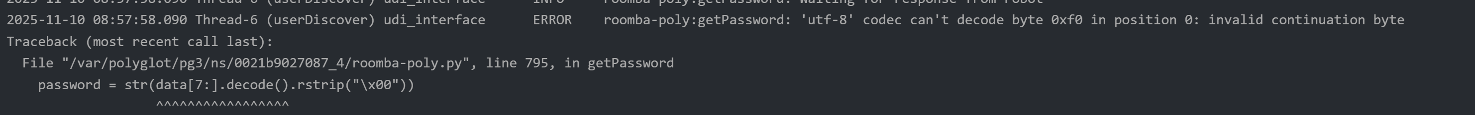

  3. Well Roombas were working with 2, 0, 14 version and made the mistake of upgrading to the latest version 2.0.17. to see if it worked and installed the nodes Nodes stayed after update but lost abilty to control the rommba from the plugin ( could no activate the roomba from plugin) deleted the nodes in eisy and the plugin and reinstalled program gives error same as Lore is seeing above when trying to parse the password tried what worked with version 2.0.14 with having the roombas in linking mode on plugin install and that no longer works gives the same error in parsing the password not sure if you can go back to a later version (2,0,14) to see if that still works Roomba_11-10-2025_90648_AM.zip

  6. EricBarish replied to oberkc's topic in Ring
    Mine is also blank. If you start a new program and go to condition for "if" and then control for selection. You will see the door bell motion under ring. Can then use as a condition for your program
  7. Success, Finally got my two roombas to install the nodes. Could not get the roombas to install the nodes by first installing the roomba node server and second setting roombas as instructing to connection mode. Program never setup the nodes. As others have experienced. Tried this : -deleted roomba node server in PG3 and eisy selected to install roomba node server on pg3 and set slot number ( did not start install) set both roombas into connection mode ( hold left botton until blue light circle on roombas) went and started install of the roomba node server once in installed it found both roombas in a few seconds and setup both nodes in eisy this has to be a problem with timing in the program ? deleted and tried again with only one roomba 1 in linking mode when I started the install for the roomba node server it found first roomba 1 that was in linking mode and installed the nodes for the second roomba node server said to put roomba 2 in linking mode, found roomba2 but then never created the nodes. deleted again put both roombas in linking mode and then installed roomba node server, both nodes installed. hope this helps to debug what is going on with the program and as a way to get your roomba nodes installed Eric
  8. Lore, Bpwwer My system is acting the same as Lores. Finds rombas but fails to create the nodes. These rombas did work with the plugin a few year ago. Have been following along, debug log stream looks the same.
