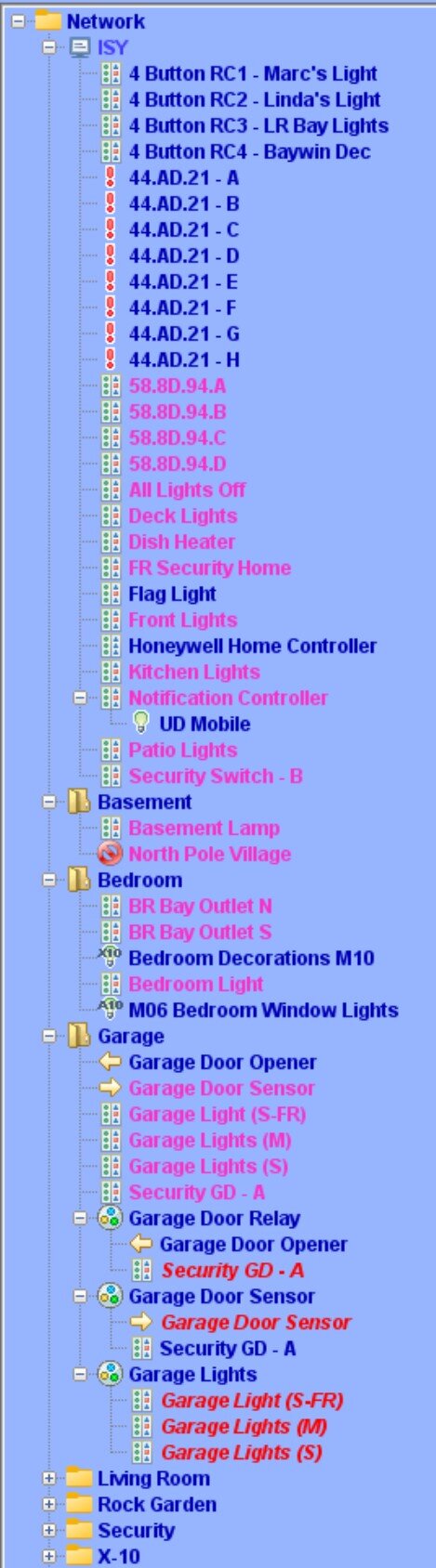

  3. My folder tree starts with "Network" then under that is "ISY" I also have folders under network for different rooms and scenes. I'm still working through a setup that makes sense. (See Main Listing below) Shoud they all be under the ISY folder? Under the ISY folder I have a bunch of individual units that I have not put in folders yet. Should they all be under the ISY folder? I'm thinking that the query command I've set will only query the ISY folder and none of the others? (see Query below) Thank for all the info! Just really started digging into what this system can do and trying to streamline things.

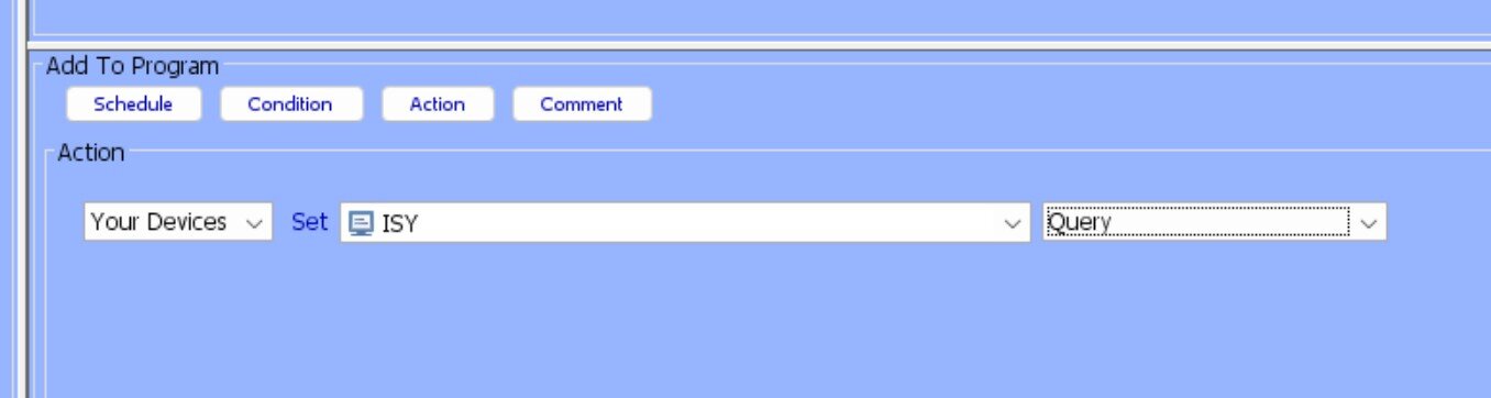

  4. So I checked my old ISY and the NODE is the Mac address of the 994i. So I need to change the line to my current mac address. but not sure how to load the line to say <cmd NODE="**:**:**:**:**:**" ID="QUERY"/> Any Ideas?
  5. I migrated my ISY994i to an EISY a while ago. Everything seems to be working fine, but from the very begining there was a "Query All" program that had the comment line "Factory Query Program" that was there from the start and I never messed with it. I just noticed that in my EISY the program shows yellow and it has the lines: " //Warning: Unrecognized Action (program may not run) ''<cmd NODE="00:21:b9:02:3f:3b" ID="QUERY"/>" Not sure what the program was for and if it is even needed anymore. Has anyone else seen this?
