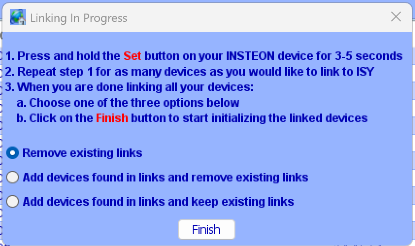

  2. So in the "Linking in Progress" screen I'll select "Remove existing links" and this won't affect any of the other switches, links or scenes that are already set up for other devices ?
  3. Still Noob at this. Determined one switch was not operating (Front Yard - Garage SL). Tried to reset it. No luck. Bought a replacement 2477S switch. Physically removed old switch and wired in the new switch. Now I'm trying to program it to the system. I read the section in the cookbook but I'm not sure which of the choices I should use. I want to keep all of the original switches, links and scenes in place, just install the one new switch into the system. I painted myself into a corner with the "Linking in Progress" forcing me to choose one option. Any help would be much appreciated. Thanks

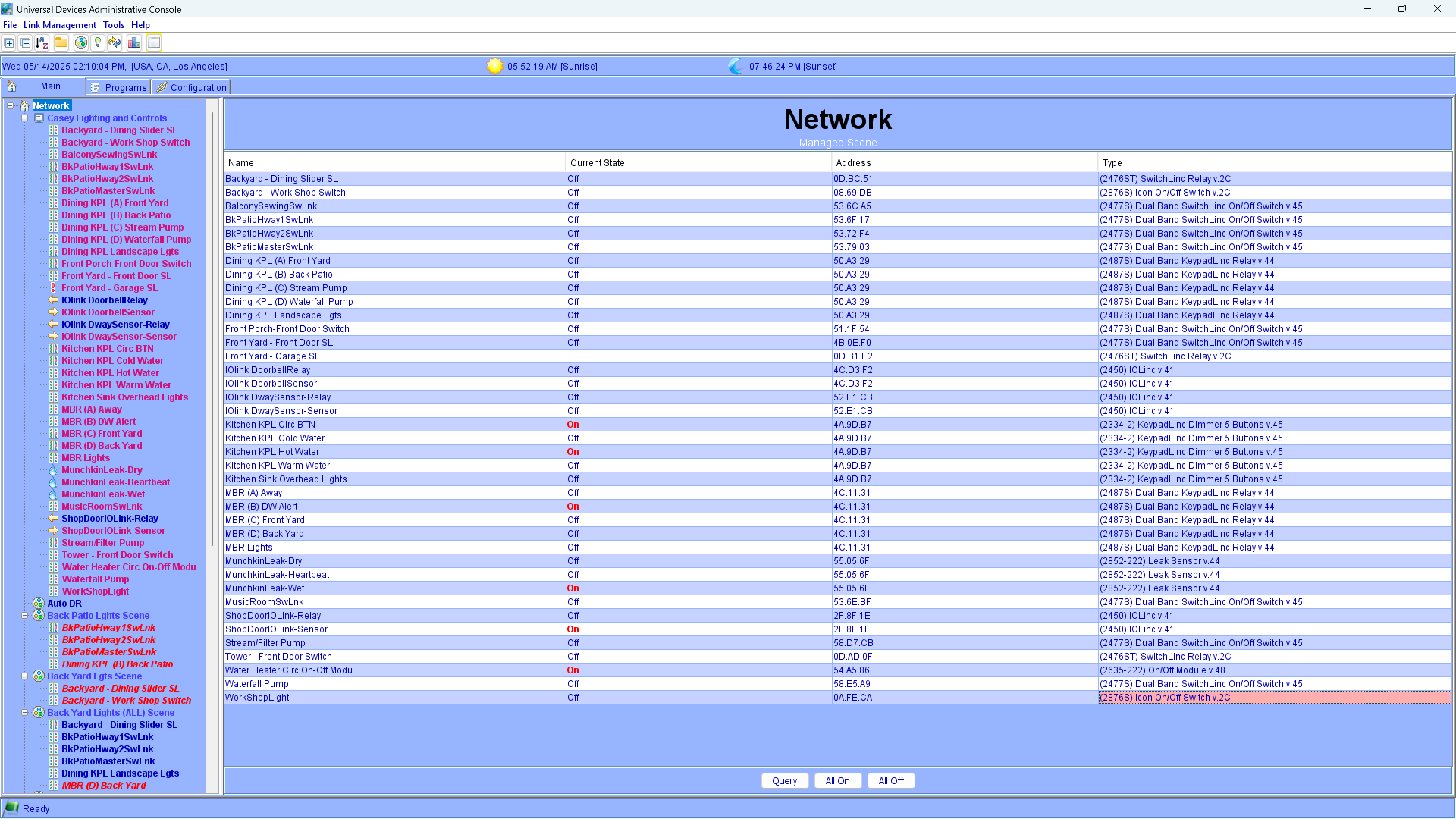

  11. Okay I found the problem. One of the Insteon switches is no longer communicating. It's a 2476ST, a switch with the timer. I tried looking for a replacement, but they are discontinued. Is there another Insteon switch I can use in its place or better yet a newer version of with a timer function?
