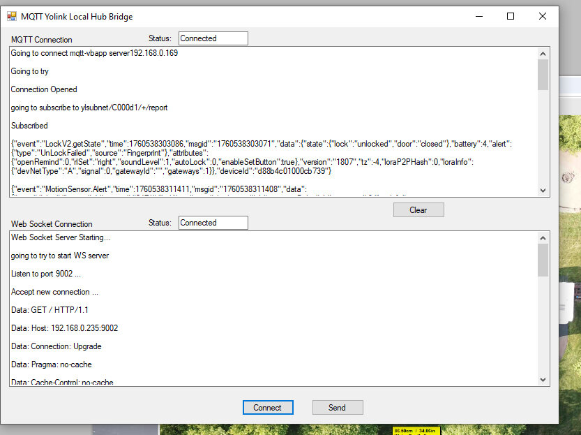

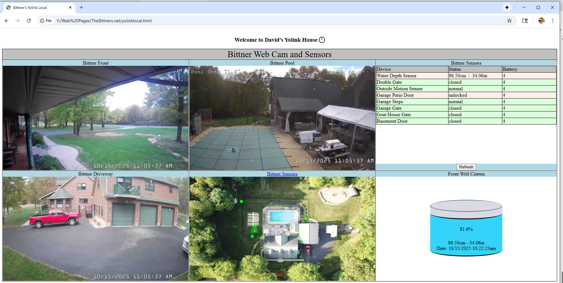

    Yolonk Local hub! I love this over the cloud based api. It did take me a while to figure some of this out and I do not have alot of their sensors and devices yet. I was able to create a web page (currently I just am hosting this on my personal cloud drive it is not being served up via web server yet) I've been able to use ajax for most of the api calls and I do have a sql database to keep track of my devices that I use to allow me to position the devices I am overlaying on a photo I took of my house with a drone. The harder part I was working on this week was the MQTT bridge to websocket so I could use just straight javascript for real time updates to my overlays. It says in the doc that port 8003 and 8004 are good for the websocket mqtt connection but they are not open on at least my local hub. Anyway here are some photos of my web page. If anyone wants to do something like this I might be able to help you out. This was such a struggle for me because I could barely find any info on the api with javascript. youlink is really good about answering my emails.
