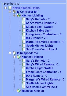

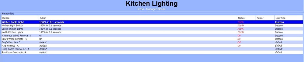

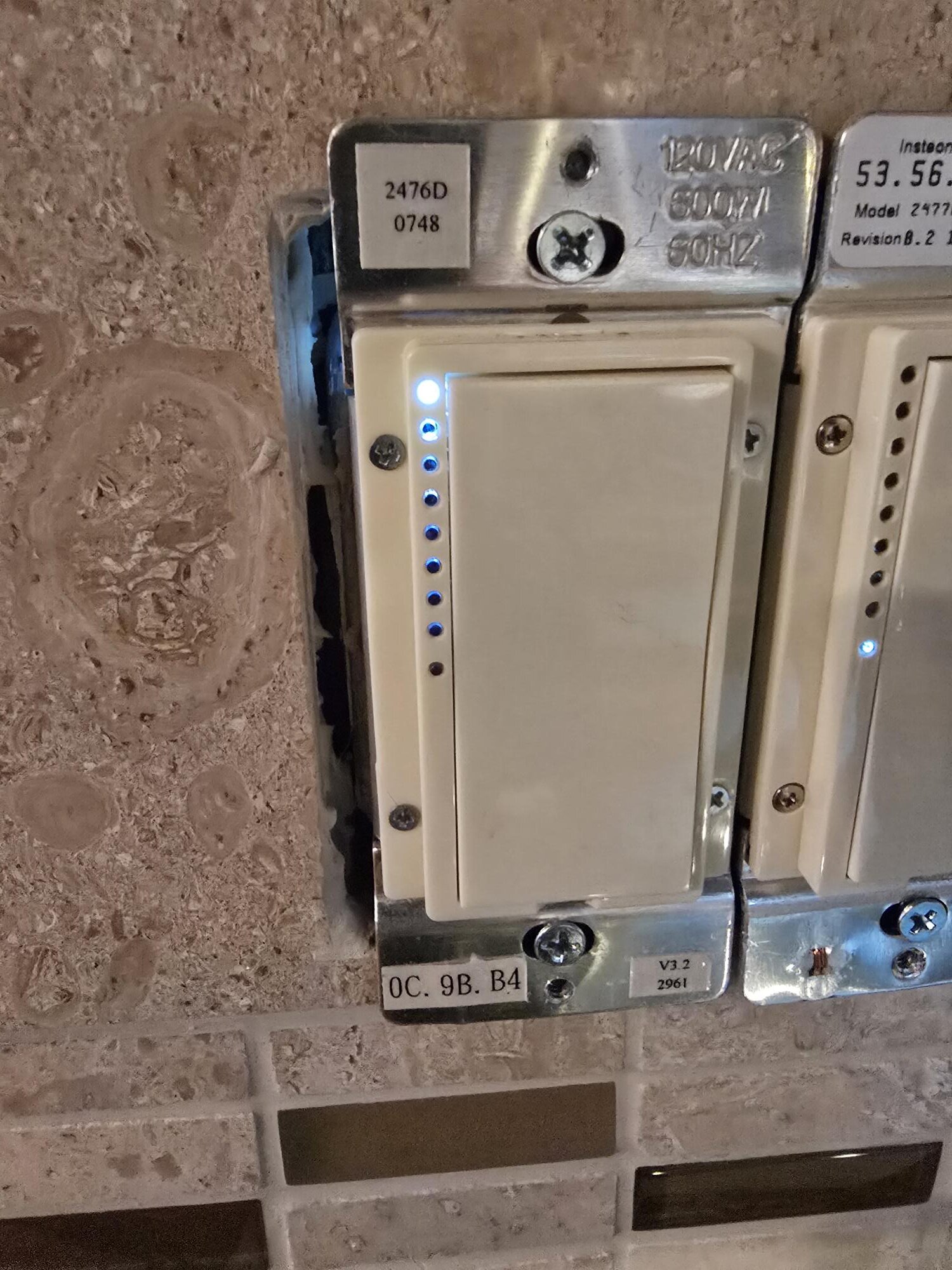

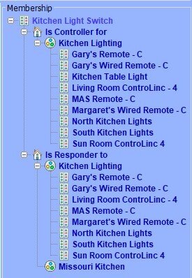

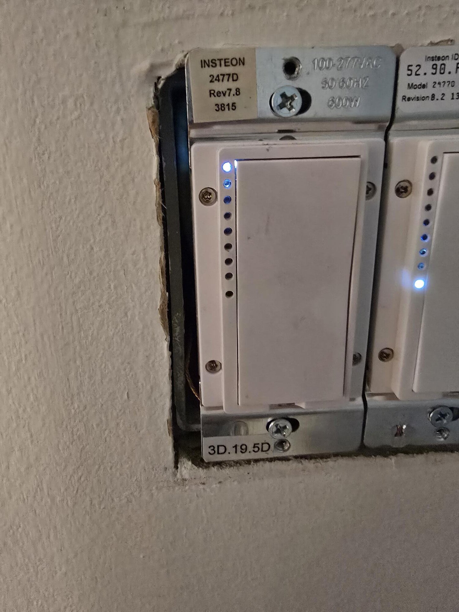

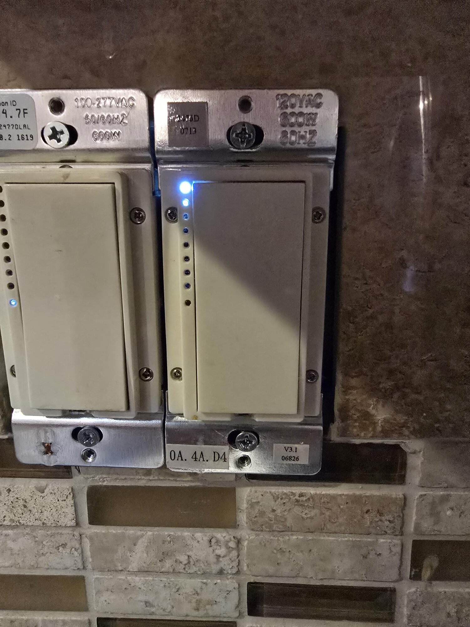

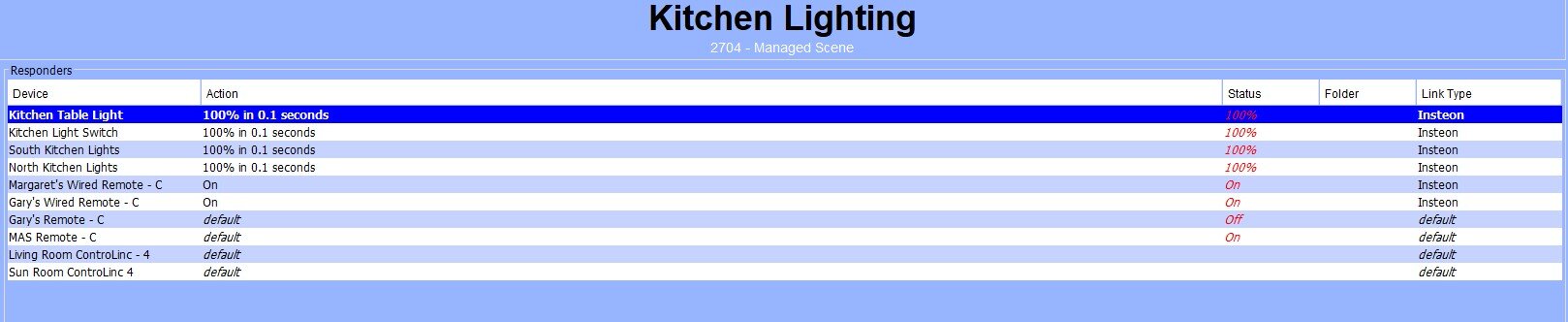

  2. I have 5 ceiling canned floodlights that in the past few weeks have started to behave weirdly. Three of the lights are controlled by a single Insteon 2476D (South Kitchen Lights), two of the lights are controlled by a single Insteon 2476D (North Kitchen Lights), and there is a third switch that can control the first two switches. Actually, the North Kitchen Light Switch and the South Kitchen Light Switch turn on all 5 lights. In addition to which I have a Universal Devices ISY 994i/IR Pro running 5.3.4 Firmware. When I turn on the lights the South Lights come on, and after a few seconds the North Lights come on, and a few seconds later the North light go out for a few seconds and then come back on. This blinking repeats itself several times before the North Lights remain on. I should add that while the switches are dimmers, I don't ever dim any of the lights. I am attaching pictures of each of the switches and screen shots of the Membership for each of the devices and the scene I have created. I would appreciate any guidance in order to determine what needs to be done to correct this behavior.
