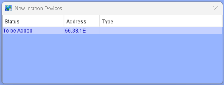

  3. Well rebooting the Eisy did clear the "New Device to be added" pop up, but still unable to get it to link to the Eisy
  4. I first lost connectivity between an existing Insteon 2477D, so I figured it was a bad switch and replaced it with a new one. When I try to connect my eisy to it, it comes up with an error message that says "Request Failed". If I shut down my Admin panel and restart it, I get a panel that pops up with " Device to be added" with the correct address for the switch that I am trying to add ... I'm stuck. Any advice?
  5. How do I make this stop??? It displays about once per minute and stops everything, until I close it.
