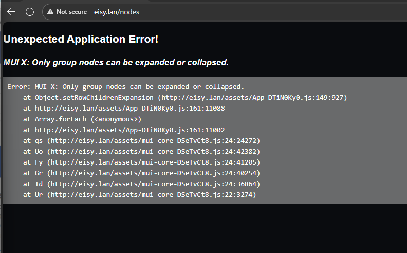

  11. A few things: 1. Nice overhaul. I'm liking the UI so far. 2. Whenever I try to use the search bar on the nodes page, I get this: 3. The nodes list will re-expand itself almost on a timer. Let's say that I'm collapsing the nodes to make it easier to find something further down. Maybe I click on something within a node to check it out after a few collapses. Sooner or later (usually withing 15 or 20 seconds) all of the nodes re-expand.
