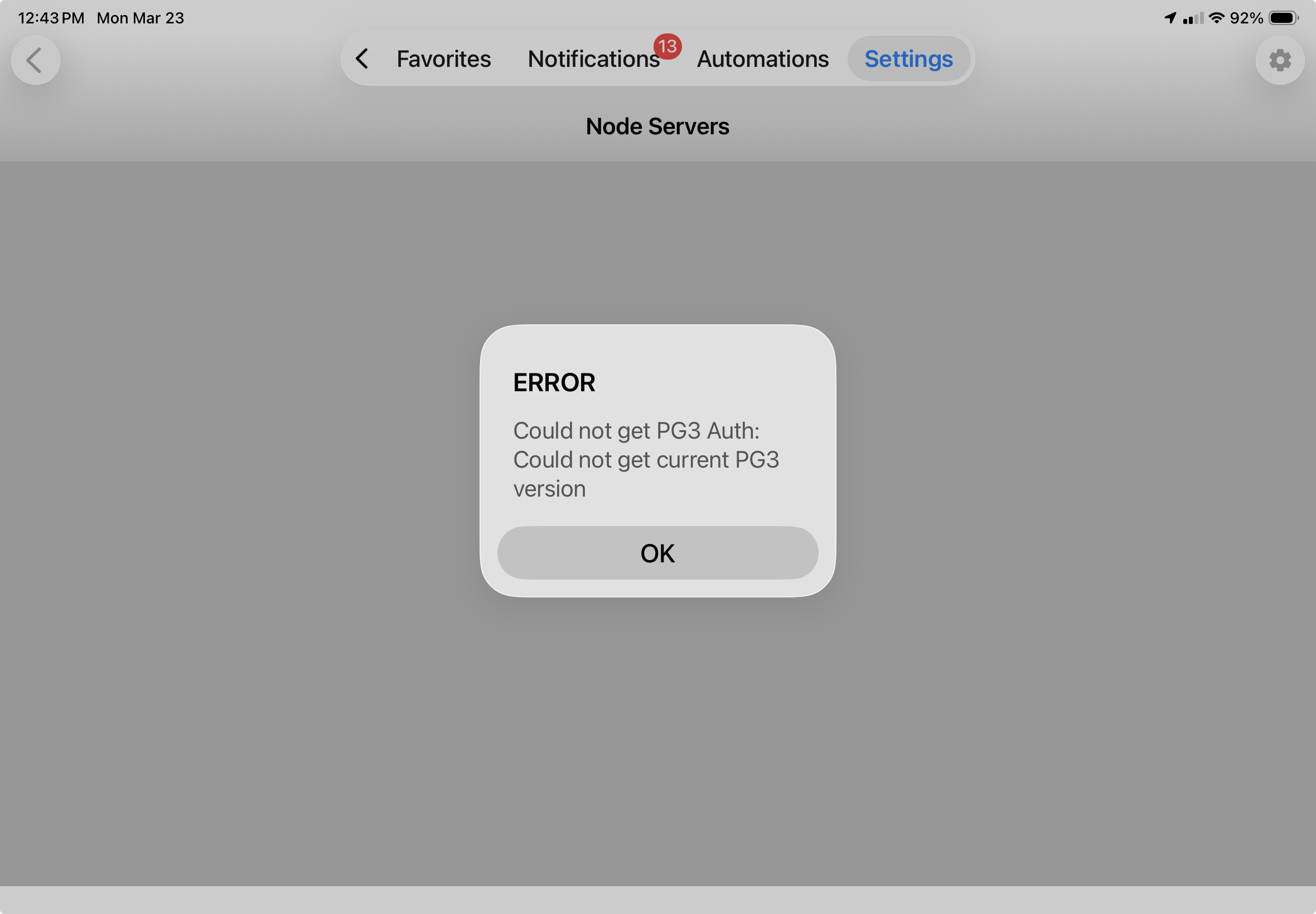

  1. Just went back in and ran upgrade packages again and rebooted - PG3 started up this time, everything looks correct, yes, I can now reach through the eisy.local link. I will do some more checking but optimistic.....

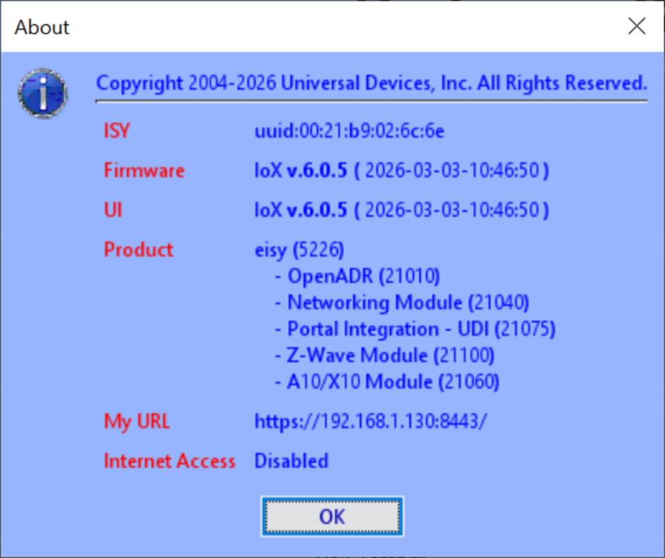

  2. From the IoX Finder: From the EISY-UI And from UDI Mobile All with the same result
  3. Greetings - just updated to version 6.0.5 which seemed to go smoothly but getting error trying to access PG3x: This page can't be found. Followed other posts: unplugged, reboot, upgrade packages, clear java cache. Tried executing from IoX finder, admin console, and UDI mobile. No joy.. What to try now?
