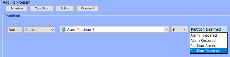

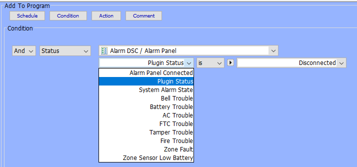

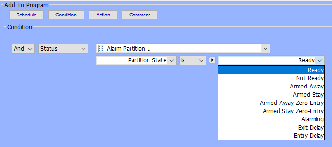

  2. OK, got it. I was looking under Alarm Partition Control (and it wasn't there)... and for some reason when I switched to Status it showed the Status options for Alarm Panel Status not the Partition Status... ...which is where the entry and exit delays are located. Thank you!
  3. I was using the DSCLink Server with my ISY994i and I used the "system in entry delay" and "system in exit delay" functions in several programs (like turning on the house lights when the entry delay is on after sunset). Now I've migrated to EISY and I've installed the Envisalink DSC plugin and have started to use it to replace the functions of DSCLink server. However, I cannot seem to find any entry or exit delay states on which to base some programs. Any help would be appreciated. Thank you!
