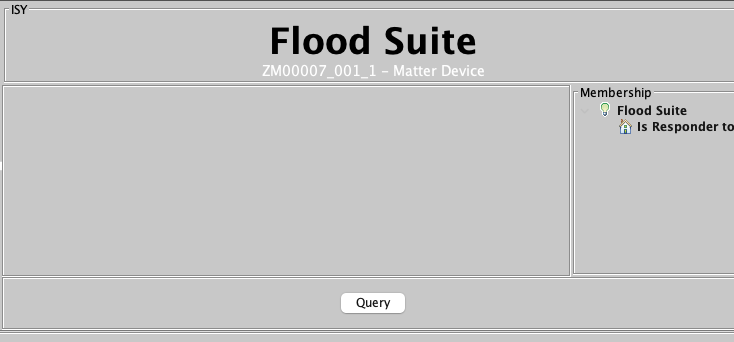

  1. I'd like have the Shelly Flood Gen4 fully recognized completely as a matter device (now it just appears like here) Manufacturer Name Shelly Model # S4SN-0071A Link to sales/availability site(s) https://www.amazon.com/gp/product/B0FPG9SGLJ/ref=ewc_pr_img_1?smid=A33RI86K4PO1EO&psc=1 Key/desired function support: Leak detection After facing a major water leakage at home, this is now a must have. Shelly knowledge base, just for information: https://kb.shelly.cloud/knowledge-base/shelly-flood-gen4#ShellyFloodGen4-Installationguides
