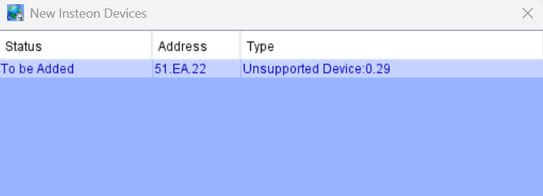

  7. I plugged in the "2922-222 Insteon Plug-in Range Extender, Repeater and Access Point" and tried to link it. The ISY found it but gave me an "Unsupported device:0.29" error. The failure reason in the event log was reason 10. Let me know what you think when you have time.

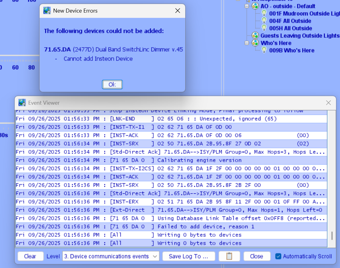

  8. Yep. That's my thinking too. The old devices are at most 12 years old. The new devices could be brand new (1 year) or at most 5 years old - sitting in a box-unopened until they were installed a 6 months ago. I have a spare PLM. The original PLM died many years ago but was able to solder in some new capacitors (etc - can't remember what I replaced off the top of my head) to get it working again so I never used the PLM I bought to replace it. Maybe I'll try to find the "Line booster" or whatever it was that I bought... and install it. I tried level 3... "failed to add device - reason 1"

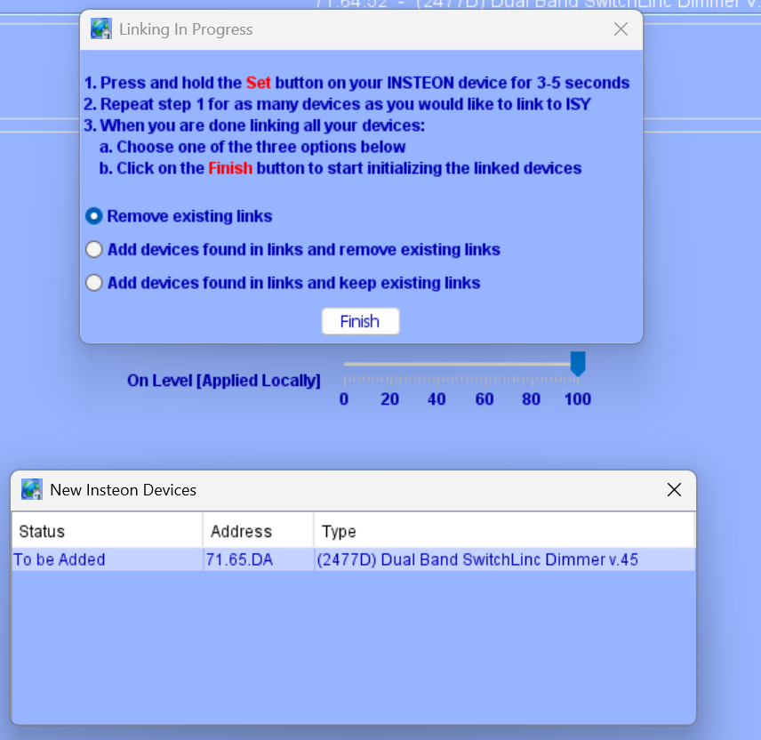

  9. I tried both ways. The "Automatic way" (clicking on the "start linking" button and then pressing the tab on the switch until it beeps) gets me to a point where the device shows up in the list. Then when I click "Finish" it says failed to add. I added a screenshot.

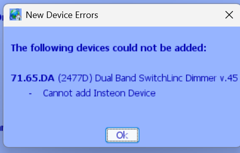

  13. Hi, First question: How do I upgrade my isy994i(1120)? A link to the firmware would be great. I'm currently running v4.9.0 I'm trying to add some new devices and most of them are failing to be added. Not sure if the devices are "too new" for the firmware. One device, a 6 button KeypadLinc gets added but the "A", "B", "C", "D" buttons don't show up. The device (according to the isy) is a: 2334-2 KeypadLinc Dimmer 5 Buttons v.45. However only one device is added (the A,B,C,D buttons are not added) when I click add. The other devices are just regular 2477D Dual band SwitchLinc Dimmer v.45. When I click "Finish" the "Status" in the "New Insteon Devices" window changes to "Add Failed" and the only error I get is "Cannot Add Insteon Device". Not sure if there are logs I can look at to figure out why it is failing. A link to the trouble shooting guide would be helpful. I'm hoping that this is a firmware issue and upgrading the firmware will fix the problems. Thanks for your help. Let me know if you need screenshots.
