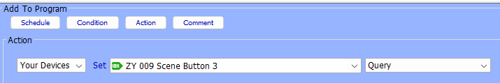

  1. Yeah, that was it. Thanks for pointing out the obvious, that I missed...
  2. Hello All, I have a Zen32 800LR. I'm using a program to interact with the device, however, I'm unable to set a parameter through a program. For the Action in the Then statement my only option in the drop down for a Scene Button is 'Query'. Can someone explain how to set a parameter? I'm not sure what I'm missing. As an example, my Then would set parameter 7 to a value of 2 to set the LED to green on one of the buttons. LED Color For Button 1 Parameter 7: Choose the color of the LED indicator for Button 1. Values: 0 – white; 1 – blue; 2 – green; 3 – red; 4 – magenta (RB); 5 – yellow (RG); 6 – cyan (GB). Default: 0. Size: 1 byte dec
