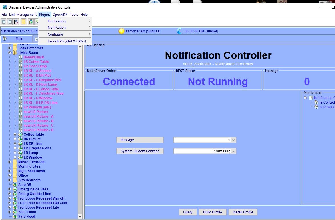

  5. My system was just loaded with 6.0 and previous 5.8.4 backup restored. All is fine except for Notifications, emails are working fine but notifications to UD Mobile not. I am seeing two notifications on the Plugins drop down, is that normal? It has been many years since I first set this up I don't remember seeing it twice. Looks like i need some pointers on notification setup.
  6. Thanks to you both. The reboot resolved it!
