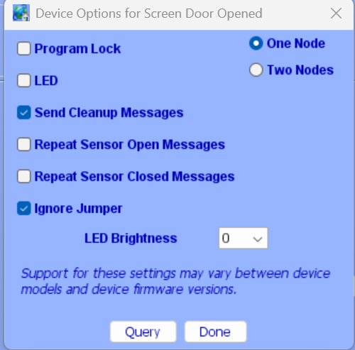

You really only need the two nodes, open and heartbeat. If the sensor isn't open then it's closed. However,  in the eisy if you look at the options for the open close sensor you'll see the option for the close node (2 nodes).
It's also possible that insteon, in the current sensor firmware, eliminated the close node.
Techman:  You are THE man!  That was exactly it.  It's one of those obscure things that I don't think I've ever looked at before - and probably would have never found.  An of course, I would use the logic of Open or NOT-Open; However I really like the UD Mobile Push Notifications, and at a glance, I can see if a door is Open or Closed, without having to look at the yes or no for open.  :)    I really appreciate your great guidance and your willingness to share your knowledge!
