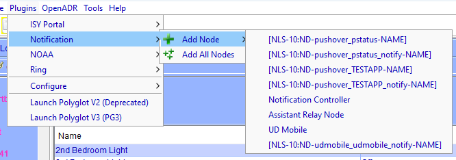

And IF I go to the menu PlugIns ..   Notifications ...Add Node..  I see
And was figuring I had to add the node back manually !!!!
Are you talking about the Add Node menu selection in the AC ?
Before I messed with it.. I hade a Notification Controller with a sublevel that listed
Yes, you should never use that menu to modify a plugin or it's nodes. The plugin handles it's own nodes.
