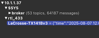

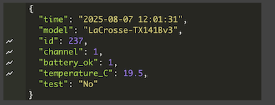

MQTT Explorer reports:
image.png.49298c9d403ec0d81ae8428fc609fce4.pngimage.png.70d66ac02e7a52dad5b200b76c0b7a93.png

Hi @evilpete,
The MQTT plug-in was designed for Tasmota integrations. Tasmota doesn't send JSON packets, only individual data points.
I think @sjenkins added one or two devices, which send JSON packets. He might be able to shed more light to see, if using his device-type will better match your needs.

@evilpete , your issue is these devices do not read a JSON string from MQTT but rather individual variables.
so your MQTT should look more like this..... (sorry this isn't a raw example but the form factory holds).  You will need to write your JSON string using each variable.
Does not matter if your device is Tasmota or not ; in fact when I started using, then modifying this plugin I didn't know what Tasmota was & still have never used one.  What matters is the form it hits the MQTT ; that's the beauty of MQTT !
Not sure if you are sending with Python or with C, C# but works similar in both, the topic in the below case is /sej/awning/status/hb while the message is ON.  You are sending the whole JSON as one message in a topic.
hope that helps
