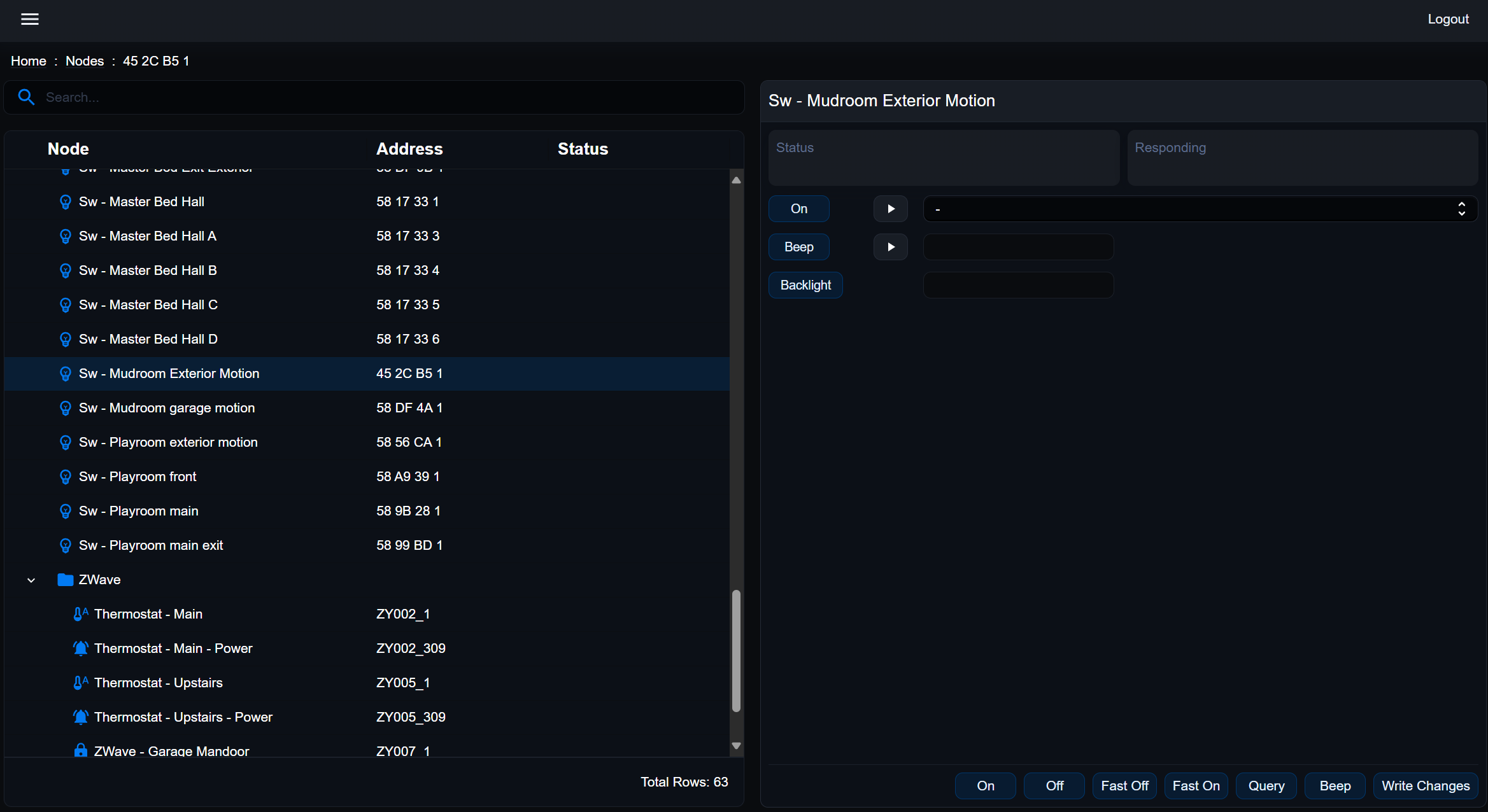

I just did the upgrade and was poking around the eisy-ui interface and alL the devices are present but not information is loading about them (like status). The controls do work (on/off) but no data is showing for any devices.
any ideas? I’ve done the reboot (few time) and validated that statuses are showing on mobile UD as well as jnlp thick client.

Adding screen shot

No status at all is not normal.
Please open a ticket referencing this post, and add your uuid.

We have not figured out the cause of the missing status, but we added logging which should help identify the cause.
If possible, if you can still reproduce the problem, please open a ticket with both a screenshot of AC and eisy-ui, showing the missing status in eisy-ui, and Chris should be able to take it from there.
For anyone reading this - problem resolved itself when I resolved the other issue linked here:
once i removed the ssl directory and restarted the service all of a sudden values showed up.
