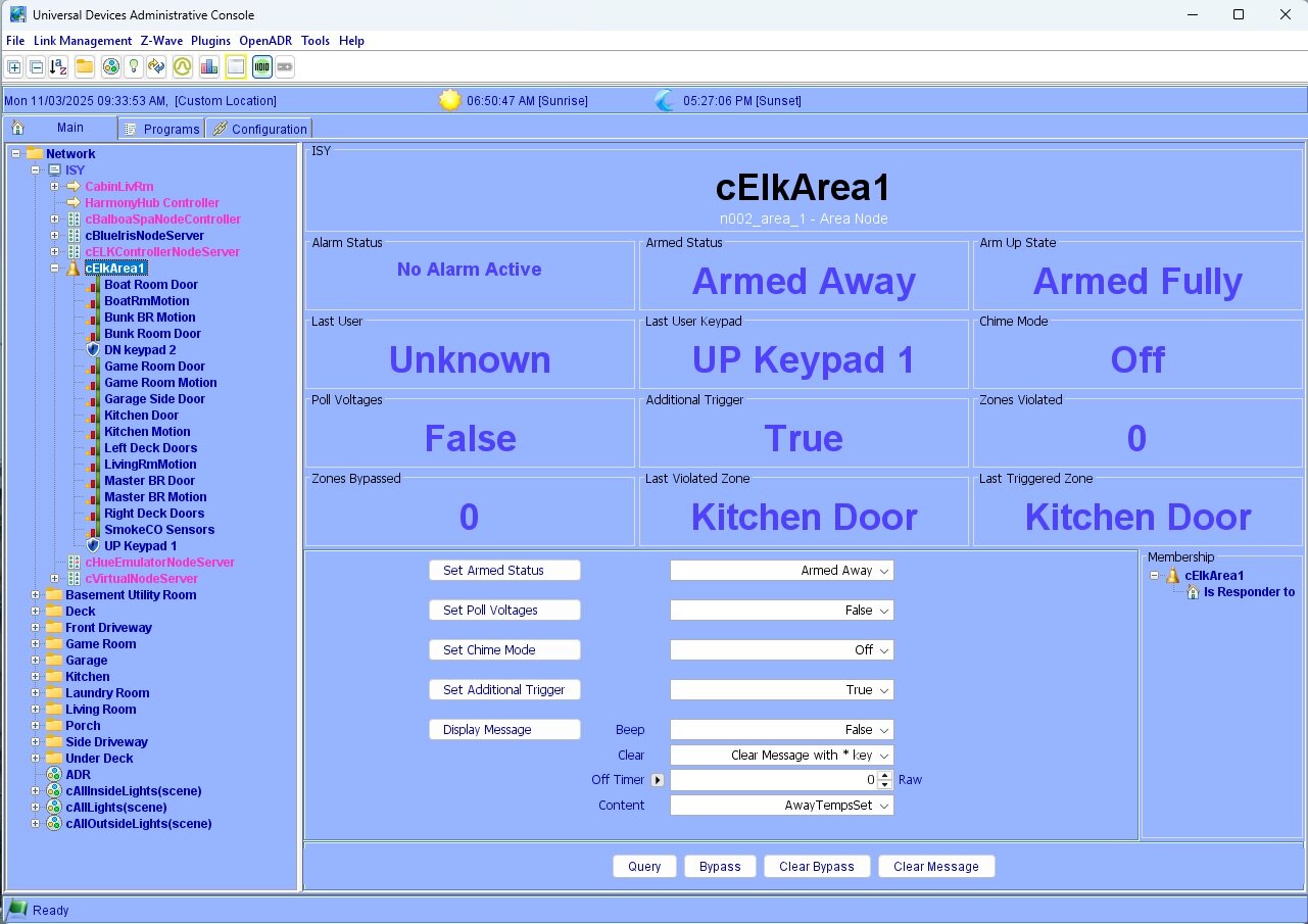

I have an Elk node server that appears in the admin console as shown in the screen shot below:

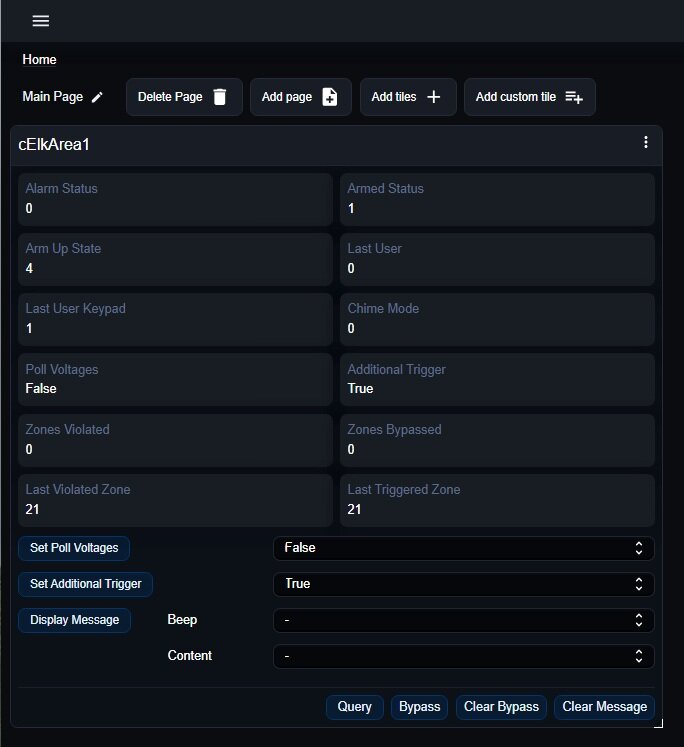

This is how the tile looks if I use the "Add Tiles" button to add the Elk node server to the eisy-ui home page:
So the four buttons at the bottom of the Admin Console Elk node are present, but lets say for example I want the functionality of the Admin Console "Set Armed Status" button and corresponding pulldown selection to be added to the tile. Can this be done, and if so, how?
There's a few things not right.
It's missing commands, and it looks like the names for status are not working.
First of all, please check the version of eisy-ui (It's displayed at the bottom of the menu). If < 0.7.2, please upgrade packages.
If you have the same result after the upgrade, ^please open a ticket and refer to this post (or attach the screenshots to the ticket).
Also please include the result of these URLs:
http://eisy.local/rest/profiles
https://eisy.local/rest/nodes
