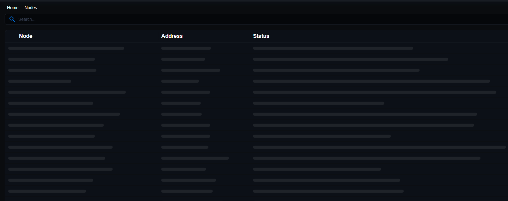

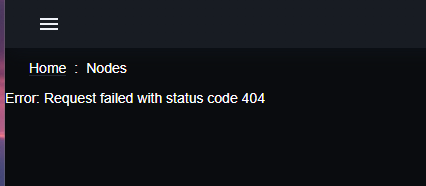

Am on 0.7.2 (had this problem on previous versions too)
When I open home page (or select "Nodes"), Chrome works for a while and either gives me error 404 or crashes. I can see my RAM going up to 95% (mostly Chrome climbing above 6 GB ) in Task Manager before the crash. Firefox doesn't doesn't chew up RAM as bad (maybe 2GB) but it keeps loading and loading and loading for minutes then returns 404

With the Programs tab, it shows them almost immediately but keeps loading and Chrome soaks up all the RAM again. Firefox also shows programs but keeps loading until 404 without soaking RAM the way Chrome does.

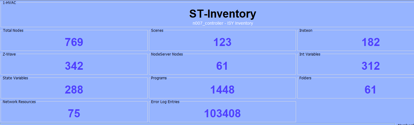

I do have lots of nodes and programs but I don't see this kind of RAM consumption with Java AC. It peaks at ~1.5 GB
So I can't do eisy.local. It doesn't resolve because I have eISY on a separate IoT subnet (VLAN), which protects devices on my main subnet from all my Internet of (Insecure) Things devices.
I tried http with IP address and, while it didn't chew through RAM and responded quite quickly, it still gave me 404 error
Problem with using http (I thought) is that I'm sending my portal userid and password in the clear and I don't really want to do that.

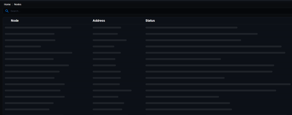

Please open a ticket referencing this post, and attach the result of those urls in the ticket:
http://eisy.local/rest/profiles
http://eisy.local/rest/nodes
