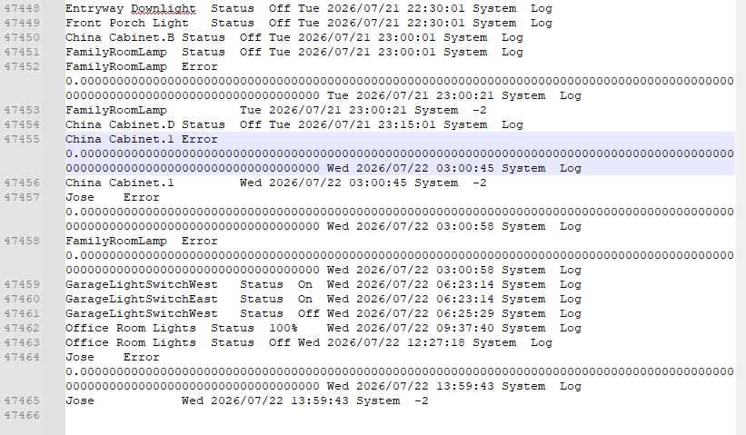

In an effort to debug my issues I've been playing with looking at the logs. I notice that some (all?) error lines show the device name, then 'Error' and then 0.00000000000000000000000000 repeating for about 125 characters. (see second screen shot)
I'm sure this is not my problem and is probably just a formatting error in the software, but it makes searching for problems the tiniest bit more difficult. Can someone look into that?

After you reslove your communication issues take a look at your log to see if the "0000000" cleared up.
