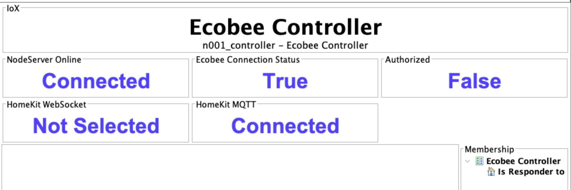

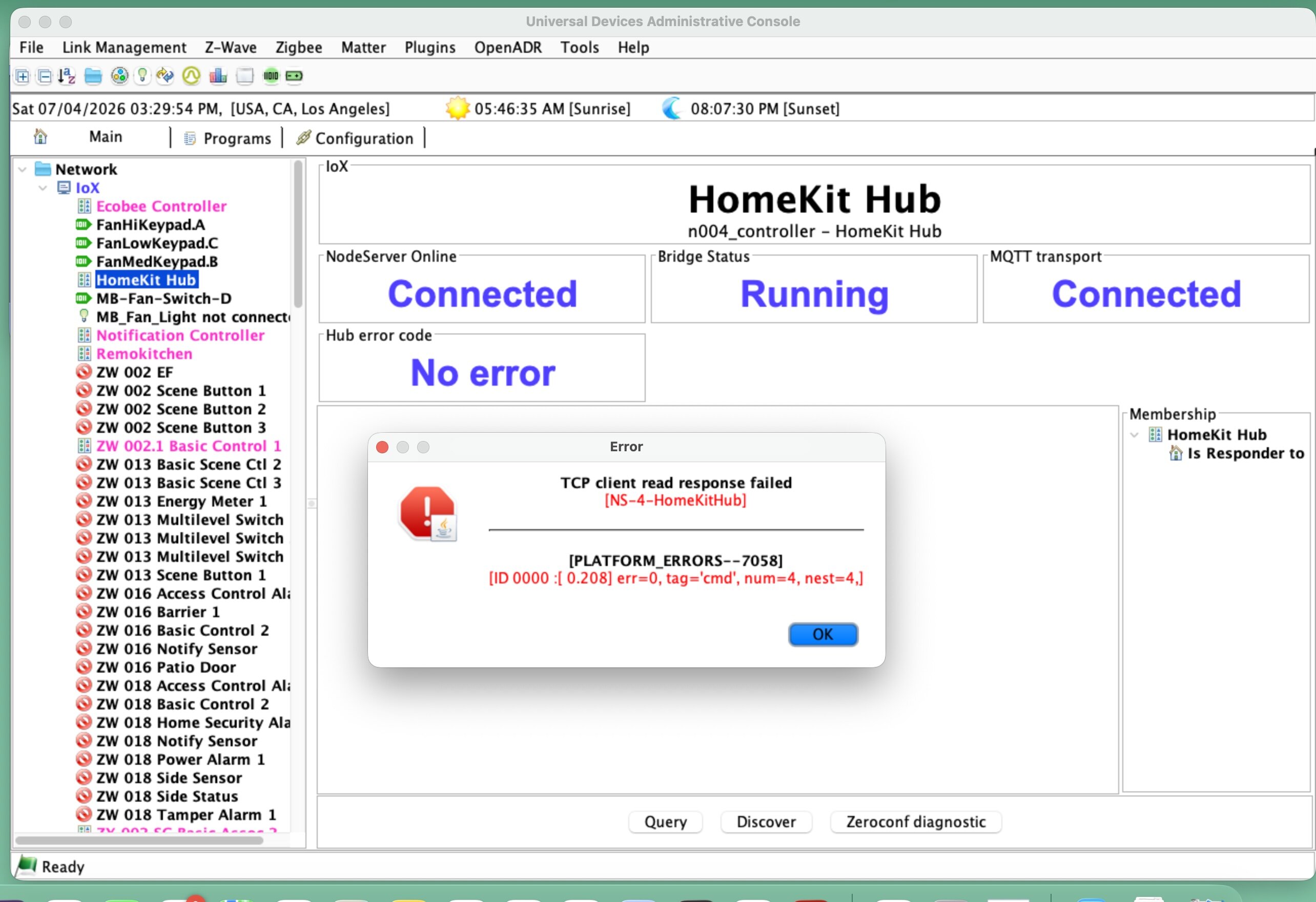

  1. Jim, I've just loaded this up and am working to get Ecobee connected for the first time. Could you take a look at this Error window that popped up after hitting Discover a couple of times? Here's the Ecobee snapshot from the eisy, too.

  6. Yes, I'm continuing to have the problem I submitted the ticket on. That is, I cannot install Ecobee node server on IoP. Oddly enough, there is one NS in slot 1 that shows up: Ecobee Controller. But, it doesn't appear to be doing anything. All of the other Ecobee node names are also listed in the Node Server dropdown. Your email response is that the username/password for this IoP isn't correct, followed by some log entries. in that log it references the node n001_rs_8jz8 as not being authorized on the IoP. I double-checked the credentials on IoP and PG3, they're the same, and I can log into each separately. That node is a room temperature sensor and the log shows a value of 75.3 deg F. so that part is working. This post, above, was sent after reading all treads re 401, all threads about sync'ing IoP and PG3, everything I could find on installing NS on PG3 and all the wikki info (yes, I did spend all day Sunday on this). But it is highly probable that I'm just not doing it right. So, I am looking for more clues because prior to Saturday, I'd never installed a NS on anything, hadn't touched my Polisy before (though I've had it on LAN for about a year) and had a very steep learning curve to get from my PG2->PG3 and retrieve/ configure my very first node server, the Ecobee ($$). Thanks, -Dave
  7. Above, when posting about not being able to get PG3 NS (in my case, Ecobee) to load into IoP, I'm experiencing this 401 problem, too. When I inspect the log in the PG3 Ecobee node, it shows that it is reading the information and posting it into the PG3 node names / addresses from my Ecobee web site. The values show in the node data within the log. Logging into IoP and PG3, I use the same ol' default admin/admin and they always log in just fine. ISY Portal is the only app that uses a different uid/pw. I use my email address and a unique password when I log into ISY Portal. ISY Portal shows Ecobee in the network services tab on the IoP. The single node name 'Ecobee Controller' is in the IoP slot 1 of the NS, but when I select "add all" from the NS server tab on the Ecobee entry, nothing happens. When I try to configure any of the other Ecobee nodes, that's when I get the little 401 pop-up window in the middle of the IoP screen. If anyone can connect enough dots to make an additional recommendation for remedying this, much appreciation. -Dave
