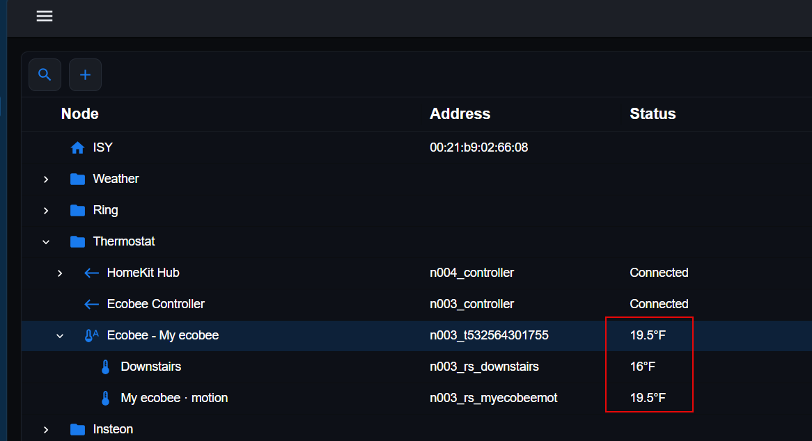

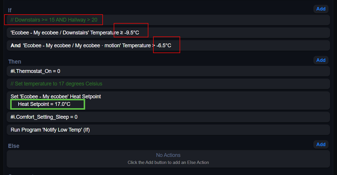

  1. Installed the plugin and it works but I am having a small problem when I set it to use Celsius. The temperatures are displaying the Celsius numeric values with the Fahrenheit symbol. Not a big issue but then in programs the behaviour is not consistent: I can set the heat setpoint in Celsius but in the 'If' statement I have to put the Celsius equivalents of the Fahrenheit values. Everything works but I find a little weird, here are two screenshots to better understand my problem: Cosmin
