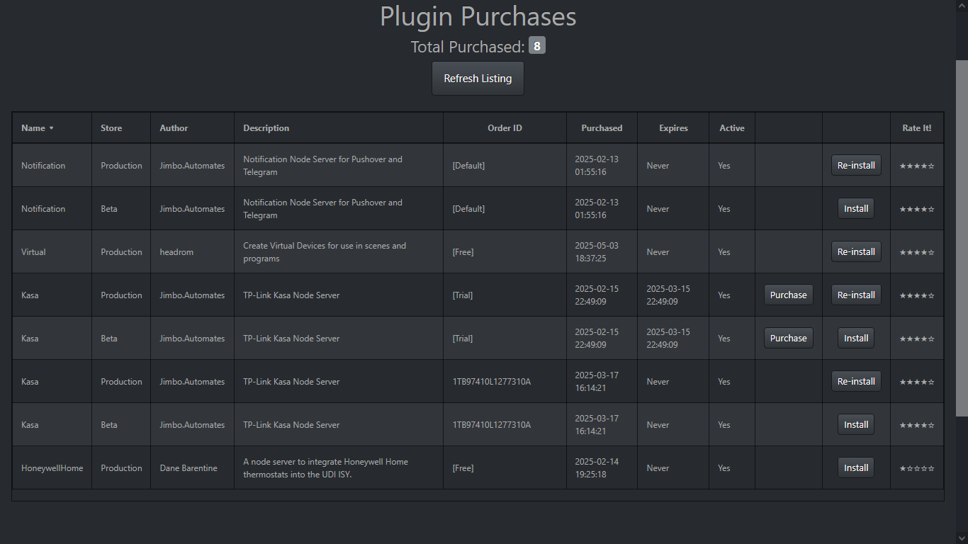

  1. I have tried to do this multiple times but I am hung up in the Plugins Store. The screen shot shows what I am seeing. When I try to get the 3.2.5 Beta, the store wants to charge me. It is also showing a nes Production version there but in trying to get it, the purchase window shows it is actually 3.2.4 Perhaps I am missing something in the process. How can I proceed?

  4. Jimbo, I am running eisy with current software. PG3x Version 3.3.18 Status: Connected Frontend Version: 3.3.18 IoX Version: 5.9.1 Connected It is primarily Insteon but I recently added KASA support with your node server. My system works well but with the following issue. I have some older HS200 that are Hardware version 5 and firmware 1.0.11 I just installed a newer HS200 that is Hardware version 6.6 and firmware 1.0.3 Build 240723 Rel 192630 Both identify as current firmware. When running the KASA production node server 3.1.4, everything else is fine including a few dimmable Kasa HS220. But the new HS200 is not found. I cannot add it by IP or by name in the Polyglot interface and the node server doesn’t discover it. I was able to add it in the ISY configuration under Plugins using the device id and the controller id and it appears, but it doesn’t work. As a test, I loaded and ran the current beta version. I added the Kasa login information and the newer HS200 was discovered and ran great. Unfortunately, none of my HS220 dimmable switches are discovered in the Beta set up. Am I missing something in setup or is there a difference in the production vs Beta? Tom
