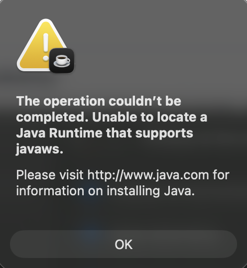

  9. This worked for me... I've been messing around with trying to get reconnected to the admin LAN console since updating and this was it for me :). Thank you a ton! Specifically this line: https://<local ip here> :8443/admin.jnlp

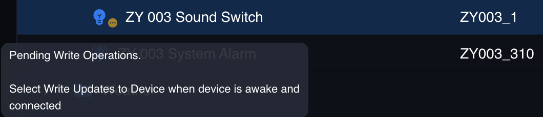

  10. Okay, so the fix for me was as follows and please keep in mind I only have 1 Z-Wave device, so that may have something to do with the directions. 1) Remove/Exclude my one Z-Wave device. 2) Click the Migrate button under the Configuration tab. 3) Add the Z-Wave device back (it added correctly with ZY node names. 4) Correct my programs with the new device node names.

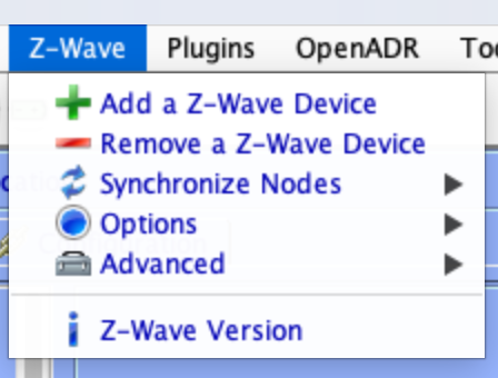

  14. @xlurkr - Yes, I did have a Zooz 700 USB stick prior to the ZMatter dongle however I already went through that process back when I replaced it. So are you saying you clicked the migrate button in the Configuration tab, then those showed up? I'm afraid that I'm going to break what works just fine by doing that though... what was your experience by clicking the migrate button, did it take you through other setup steps or anything? @jkmcfadden - Yes, I do not have those options in my menu. This is what mine looks like:
