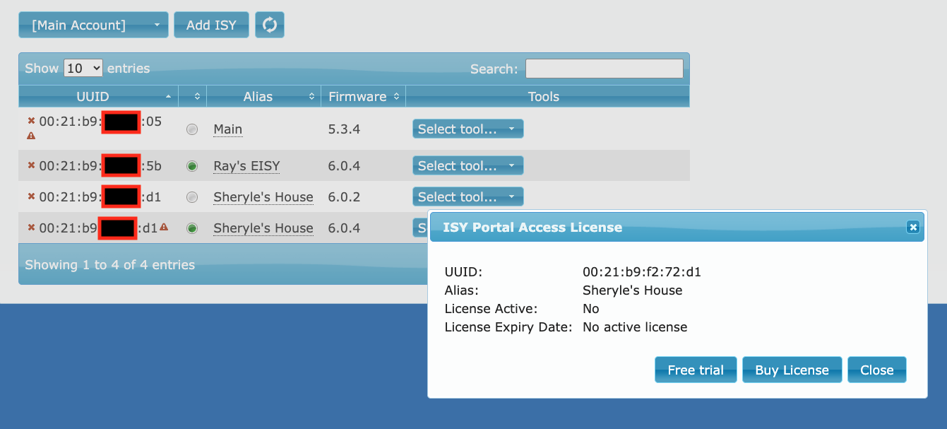

  2. both devices are active and have active licenses on the ISY Portal. I mentioned that each house has unique SSID's but both EISYs are ethernet connected. ISY Portal shows that both models are: 5226 eisy (although I know they are different somehow)
  3. Two houses, 2 different model EISY's. The houses are connected by a site-to-site VPN. The LAN is different on each house. The SSID's are different on each house. House1 I can control devices but UD Mobile does not show status House2 works fine with UD Mobile For House1, when I go to Settings, Portal Authorizations, I get a "Current Account:" shows my email address and below that I get a "No Requested Services" with a UD Mobile icon. On House2, when I go to Settings, Portal Authorizations, I get a list of 2 entries for the ONE EISY at House1 (one is eisy.localhost:8080 and the other is the IP address of the same EISY.) I realize that "finding" the EISY may go over the VPN. So House2 shows House1's EISY, House1, shows an error of some type. BUT - House2 shows correct status for devices, House1 does not. While on House2 and it shows the 2 entries for the EISY's at House1, "Select Controller" - if I pick either I get a popup window that says: Example Example Message (OK Button) I have tried to sync both devices with wifi turned off. No change. Latest firmware is updated 6.1.1 on House2 and 6.1.2 on House1 House2 has one of the newer models (bought it about a 9 months ago). House1 has an older EISY bought it a few years ago. On both devices Settings --> Accounts lists the correct account. I would just like to get House1 to show current status of devices.
