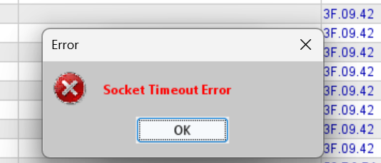

  3. Will try it but this is what I see as of now... a socket error and then this infinite waiting game
