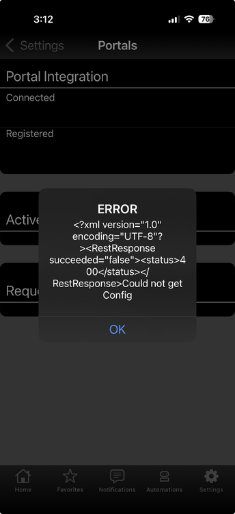

  2. @DennisC I don't think it is necessarily related to the "Invalid Credential" error. However, all this happened after I recently updated my eisy IOX and everything else. Thank you for your help in finding that post. I appreciate it.
  3. @Geddy Thank you for your suggestion. Tried turning off wifi and I didn't get the error message I posted above. I do get a spinning blue and then an error - (ERROR - The request timed out). I guess since all the devices and programs work properly I'll just not worry about it as it appears there's nothing I can do on the user side to prevent either error for that page.
  4. Thanks for the link to make it easy - udx is 4.2.0 UD Mobile is current version 1.4.7 Did system reboot twice - no change / same error

  6. When I click on this sequence "Configuration" -> "Portals" to show Portal Integration, I get the error message shown in the screenshot. Everything works perfectly with my system including Alexa and Elk integration and time module. I am on same network as my EISY. I think some information showed here once upon a time. I don't think I used this screen for important information but I'd like to find out how to have everything working correctly with the app.
