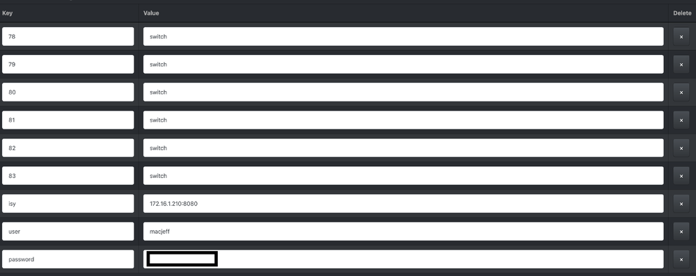

  5. Have a theory. I have intellicenter. The login to that is my email with password. So I think its looking for a different login which I dont have. Any other ideas let me know!! Devices we have Intelliflo Colorsync Intellichlor - controlled by Intellichem Intellichem UltraTemp Smart Valve for Slide Alll work fine in their app and on their intellicenter2 website. Jeff 2026-08-24 10:18:26.673 Thread-3 (custom_params_handler) udi_interface INFO pentair:authenticate: Pentair Cloud authentication successful2026-08-24 10:18:26.875 Thread-3 (custom_params_handler) udi_interface INFO pentair:discover_devices: Pentair account returned 0 device(s) 2026-08-24 10:18:26.875 Thread-3 (custom_params_handler) udi_interface.node DEBUG node:setDriver: controller:Pentair Cloud Reporting set ST to 1 to Polyglot 2026-08-24 10:18:26.875 Thread-3 (custom_params_handler) udi_interface.node DEBUG node:reportDriver: Updating value to 1 2026-08-24 10:18:26.881 Thread-1 (send_thread) udi_interface.interface DEBUG interface:_send: PUBLISHING {'set': [{'address': 'controller', 'driver': 'ST', 'value': '1', 'uom': 25, 'text': None}]} 2026-08-24 10:18:26.912 MQTT udi_interface.interface INFO interface:_message: Successfully set controller :: ST to 1 UOM 25 2026-08-24 10:18:27.073 Thread-3 (custom_params_handler) udi_interface.node DEBUG node:setDriver: controller:Pentair Cloud No change in ST's value 2026-08-24 10:18:37.888 MQTT udi_interface.interface DEBUG interface:_message: QUEUING incoming message shortPoll 2026-08-24 10:18:37.888 Command udi_interface.interface DEBUG interface:_parseInput: DEQUEING shortPoll 2026-08-24 10:18:37.888 Command udi_interface.interface DEBUG interface:_handleInput: PROCESS shortPoll message {} from Polyglot 2026-08-24 10:18:38.129 Thread-5 (poll_handler) udi_interface.node DEBUG node:setDriver: controller:Pentair Cloud No change in ST's value 2026-08-24 10:19:37.891 MQTT udi_interface.interface DEBUG interface:_message: QUEUING incoming message shortPoll 2026-08-24 10:19:37.891 Command udi_interface.interface DEBUG interface:_parseInput: DEQUEING shortPoll 2026-08-24 10:19:37.891 Command udi_interface.interface DEBUG interface:_handleInput: PROCESS shortPoll message {} from Polyglot 2026-08-24 10:19:38.087 Thread-6 (poll_handler) udi_interface.node DEBUG node:setDriver: controller:Pentair Cloud No change in ST's value 2026-08-24 10:20:37.892 MQTT udi_interface.interface DEBUG interface:_message: QUEUING incoming message shortPoll 2026-08-24 10:20:37.893 Command udi_interface.interface DEBUG interface:_parseInput: DEQUEING shortPoll 2026-08-24 10:20:37.893 Command udi_interface.interface DEBUG interface:_handleInput: PROCESS shortPoll message {} from Polyglot 2026-08-24 10:20:38.165 Thread-7 (poll_handler) udi_interface.node DEBUG node:setDriver: controller:Pentair Cloud No change in ST's value 2026-08-24 10:21:37.894 MQTT udi_interface.interface DEBUG interface:_message: QUEUING incoming message shortPoll 2026-08-24 10:21:37.895 Command udi_interface.interface DEBUG interface:_parseInput: DEQUEING shortPoll 2026-08-24 10:21:37.895 Command udi_interface.interface DEBUG interface:_handleInput: PROCESS shortPoll message {} from Polyglot 2026-08-24 10:21:38.106 Thread-8 (poll_handler) udi_interface.node DEBUG node:setDriver: controller:Pentair Cloud No change in ST's value

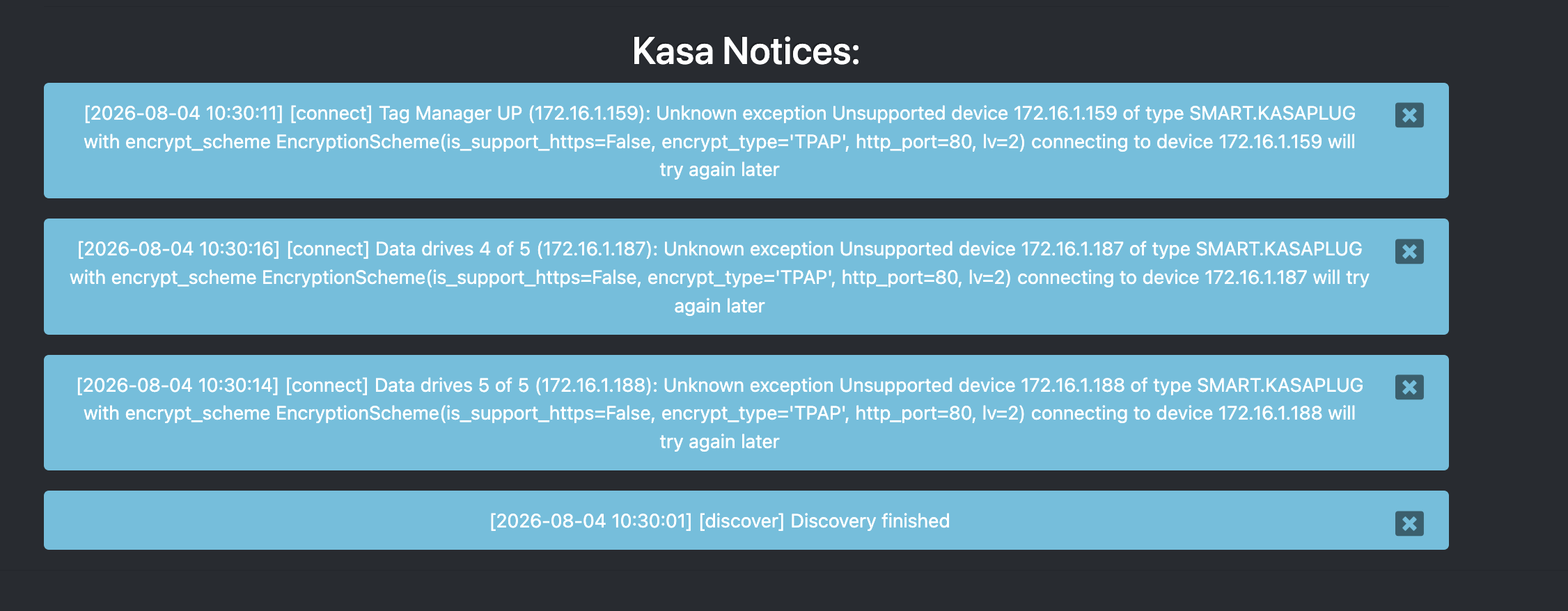

  6. which devices does this effect? Mine is KP125. I will wait for a fix but if more than a week or two I may buy some devices that dont have the issue. So far all of my other devices seem to be working (maybe not updated firmware yet) but they are different models.
  7. See screenshot. All my kp25 and other devices working fine. these broke in one of the last updates. I have been away for a while and did not realize these stopped working until today. Sent logs to Jimbo

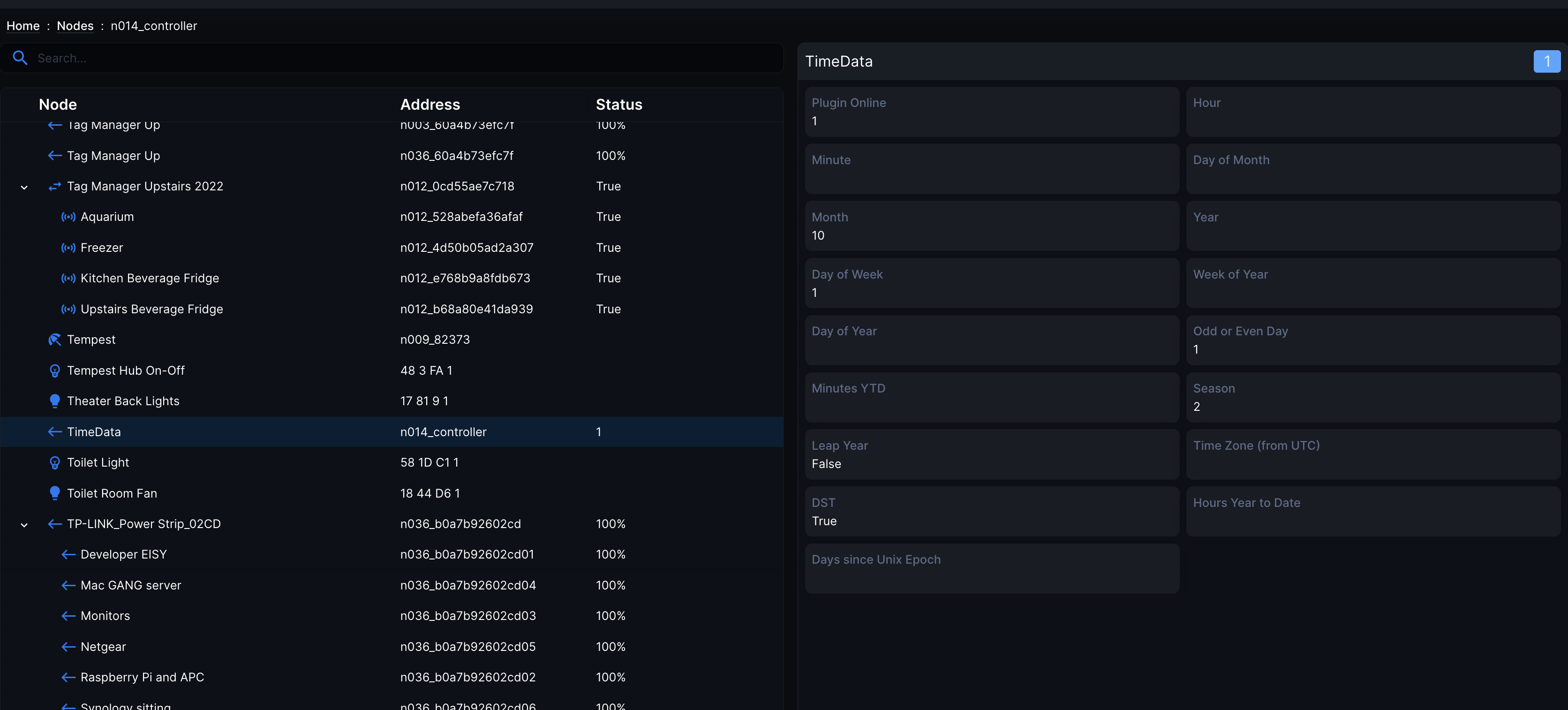

  12. I have a query in my programs at 12:00:01 as sometimes it grabs the date later. I have a program that runs at 12:02 that needs the date. Its been working every day but today the date did not change so I looked. My query program does not have timedata as an option anymore. It actually changed to something else. Can you add that back in? Jeff
