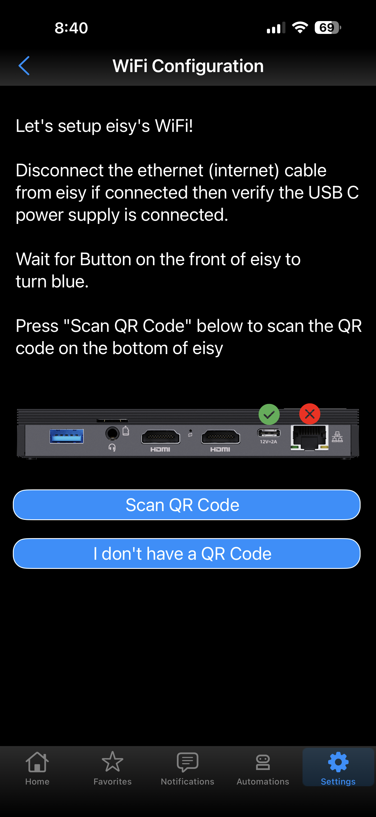

  9. In UD Mobile on my iPhone, under Settings there is a WiFi Configuration item under Admin. I have my EISY connected to my LAN via Ethernet. Do I need to go through this process it describes? See photo. Thanks.
