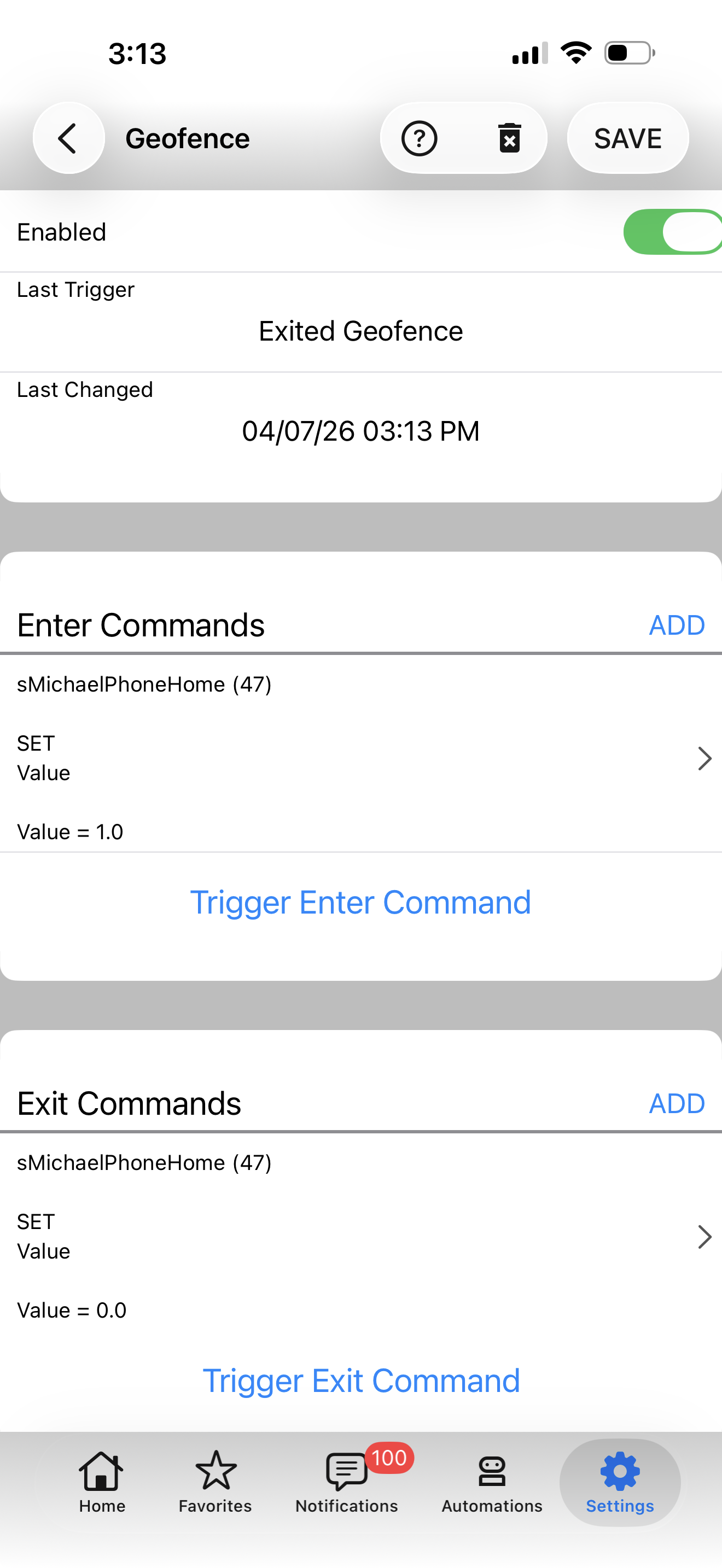

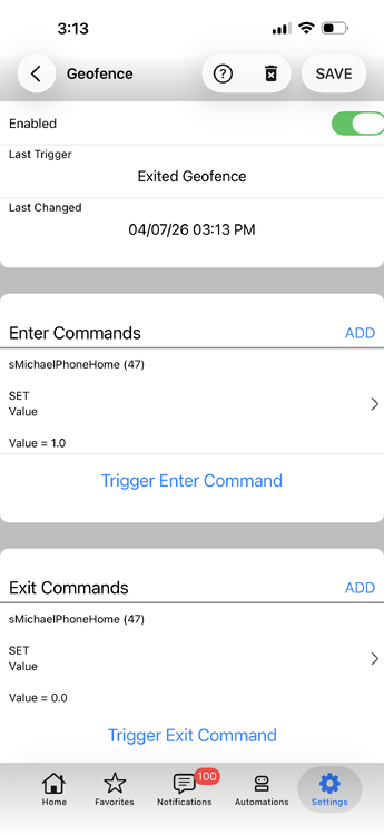

Detecting Mobile Phone Entered and Exited WiFi Range
Thanks Javi. What you see at 3:13 pm, was done using "Trigger Exit Command" to verify the var would change. I had physically gone out of Wifi range, and back into wifi range without any change to the var. I repeated doing that yesterday afternoon, but this time I turned off cellular and used a browser to show I was connected to my Wifi, and once connected, looked at the state of the var and it was still unchanged. It's been over a day since I came back within Wifi range and still no change to the var. Repeated the test again this morning, but went a different direction - checked the logs, and they show no new entries. I have had both the IOS global setting and app Location Settings enabled - specifically,, UD Mobile app is set to Always. Has anyone had entering and exiting WiFi range trigger when running on and iPhone, and if so, what settings did it take to get it to work? Javi - Any other solution you can think of (other than using a beacon) to signal I'm within range? Normal geofencing has been unpredictable/unreliable, but generally close enough that when I'm near the house I should be within the geofence circle. I am outside the city and surrounded by hills, so cell towers are few, and we are relying on signals which are bouncing off of hills.
Thanks Javi. You mentioned a couple of things: "usually triggered when the device connects to a WiFi access point" "(including access points which do not belong to you)" Does "usually" mean it doesn't always trigger, when the device connects to WiFi? Or, is not predictable to when it changes the var? Does the second part mean I can't restrict UD Mobile setting the var only when it connects to my WiFi? If so, that may explain why I didn't see a way to set my WiFi SSID. Is this not possible to limit the trigger to only my WiFi? The attached capture is what I had set up over the weekend, but haven't seen it reliably changing var sMichaelPhoneHome - At this point, not even sure if it ever changed 🙂 Thanks again.
I want to set a State var to 1 when I come into wifi range, and 0 when I go out of range. Is this doable?
