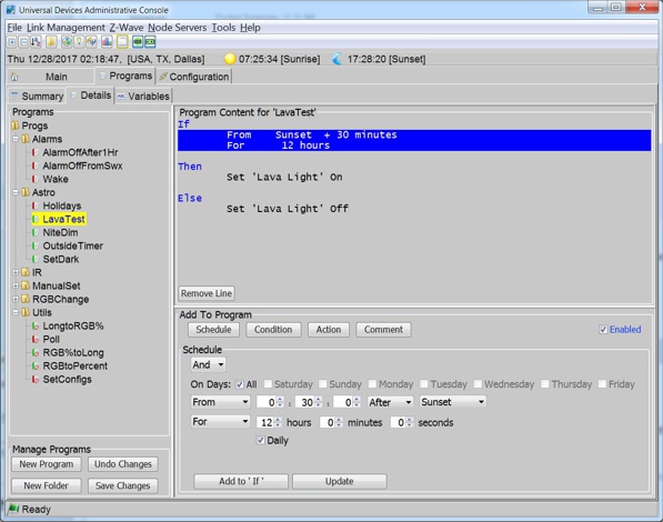

DrLumen Posted December 26, 2017 Posted December 26, 2017 Just curious, would this not work? IfTime is Sunrise + 30 minutes For 12 hoursThenSet 'Lime Tree Lights' OnElseSet 'Lime Tree Lights' Off Am I missing the meaning or a pitfall of For?

stusviews Posted December 27, 2017 Posted December 27, 2017 On 12/26/2017 at 8:35 PM, DrLumen said: Just curious, would this not work? If Time is Sunrise + 30 minutes For 12 hours Which ISY version are you using? I don't see For 12 house as a conditional option in v.4+.
DrLumen Posted December 27, 2017 Posted December 27, 2017 On 12/27/2017 at 1:24 AM, stusviews said: Which ISY version are you using? I don't see For 12 house as a conditional option in v.4+. On 5.0.11b here. I guess that's why...
G W Posted December 27, 2017 Posted December 27, 2017 On 12/27/2017 at 1:24 AM, stusviews said: Which ISY version are you using? I don't see For 12 house as a conditional option in v.4+.I wasn't expecting the 12 house option until 6.x.
ScottAvery Posted December 27, 2017 Posted December 27, 2017 On 12/27/2017 at 2:01 AM, DrLumen said: On 5.0.11b here. I guess that's why... I don't use 5.x yet, but usually "For" is used to create a loop, which I assume is why the feature was added, allowing you to do more in one program where version 4.x requires multiple programs. For scheduled events, "From" x "To" y is the standard method to do it in one program. Post #6 has it in two independent programs. There is no need to have one program calling another. You only need to separate into nested programs if there are multiple conditions that need to be evaluated independently. That makes it curious that you went to the effort to put your lime tree schedule in two nested programs but didn't put the "Wan is gone lights off" in nested programs. As you yourself noted and Gary confirmed in post #2, the zone changing status again breaks the chain and stops the program. That is the time that you would want to break things up. If you still need help with that one you may need to explain exactly what behavior you are looking for and where else the variable gets manipulated.

DrLumen Posted December 28, 2017 Posted December 28, 2017 On 12/27/2017 at 5:11 PM, apostolakisl said: There is no "for" in the if clause on any version of firmware I'm aware of. The only "for" is in the then/else clause as part of a "repeat for x times" first introduced in the 5.x firmware. This is in 5.0.11b.
ScottAvery Posted December 28, 2017 Posted December 28, 2017 On 12/28/2017 at 8:25 AM, DrLumen said: This is in 5.0.11b. My guess is that is not the intended use. It will probably not reevaluate to use the else clause and will mean the program is active for 12 hours rather than active for 2 instants a day, as well as not recover from a reboot. Does the second pull down have a "To" option?
