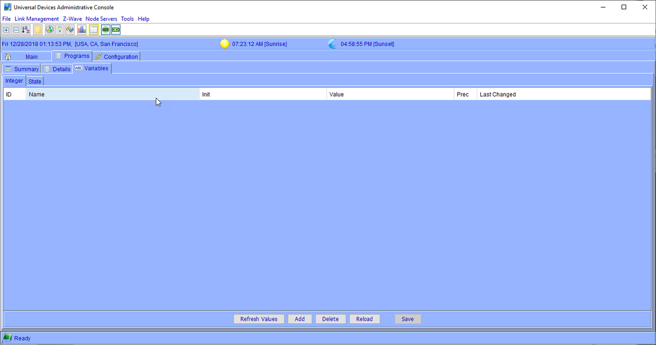

Not sure what this error is trying to tell me. NodeLink seems to be working fine, but obviously there is a problem with the ISY. Any suggestions where I can start looking?

I have two state variables on this ISY, it's mostly for testing purposes and no integer variables.int.png
Yep, that's why.  Don't worry about the error.
I'll clean it up in the next version.

It's part of the error checking IO_Guy has added to NodeLink which is awesome, for me simply adding an integer variable fixed the error. If I were to guess, yours is due to no Node-servers being present. Just a guess.
