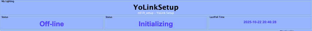

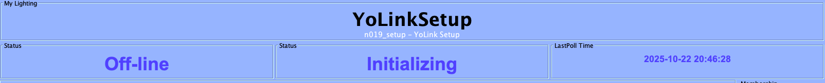

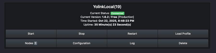

October 23, 2025Oct 23 I had to get a replacement local hub (original local hub would not show "online"). I now have the 1606 hub installed, online, and apparently running. I can control or see my four yolink devices on the Yolink app.I have installed the production node server, version 1.6.2 (free version for now). I believe I have correctly configured the node server, having added the necessary custom configuration parameters.The node server shows a single nodeThe node server shows up in IoX admin panel but shows status "offline" and "initializing".I have not found a way to cut and past between my iPad and computer, so I have carefully transcribed the various parameters, but it is still possible I have mistyped or misread one or more (I have double-checked each). I will continue to double check these parameters against the app.I have restarted the node server several times along with IoX.Is there something I am missing? Edited October 23, 2025Oct 23 by oberkc
October 23, 2025Oct 23 Can you PM me a log with Debug enabled?? - is there a space before the 5 in Local_client_IDI cut and paste to email and email it to my self I would remove the picture with your credentials - you can always PM me Edited October 23, 2025Oct 23 by Panda88
October 23, 2025Oct 23 18 minutes ago, Panda88 said:Can you PM me a log with Debug enabled?? - is there a space before the 5 in Local_client_IDLog coming soon. No space before the 5 in the local client ID.
