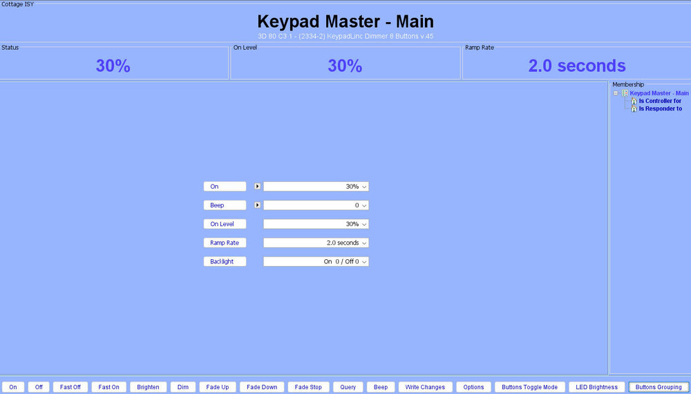

I am also attaching screenshots of the keypad's Main button's settings; of the 'B' button's settings; and the LED scene settings.
Does anyone have any suggestions on what may be wrong here or why this isn't working?
