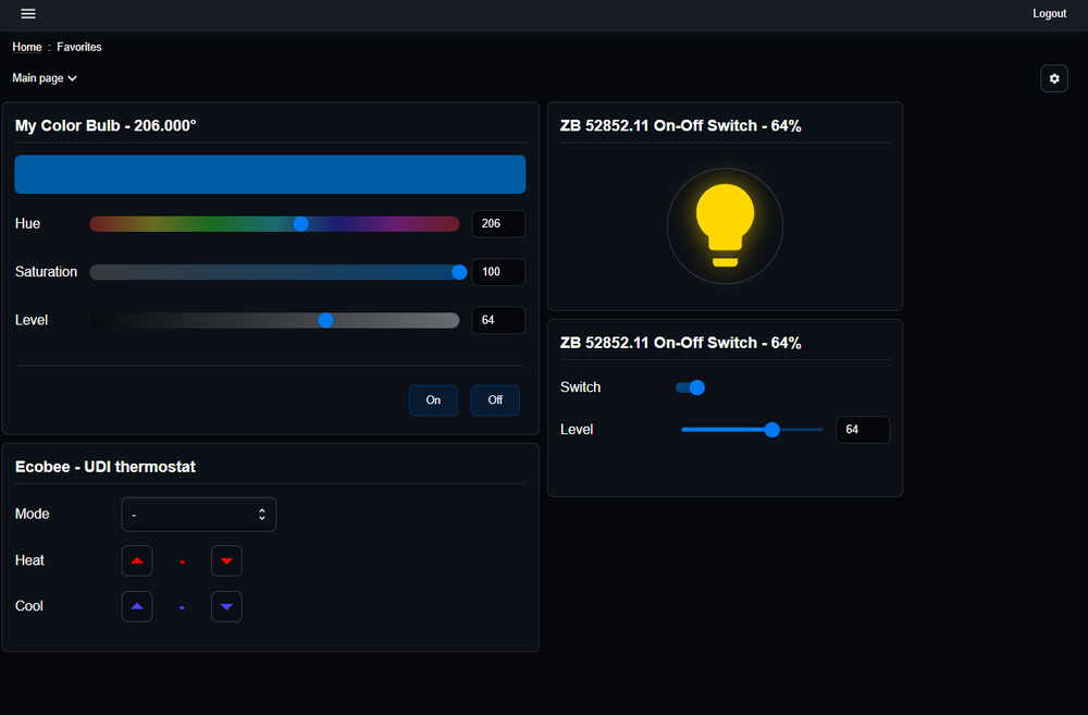

eisy-ui features
Favorites page
This allows you to create a dashboard like page to interact with your nodes. Organize them the way you like it. Just display the properties and controls that are relevant to you. Use widgets to create an intuitive interface to manage your lights, color bulbs and thermostats. Group relevant nodes within the same tile.

Here's a few screen shots
