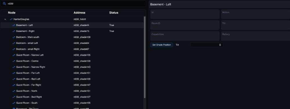

@bmercier , sorry I wasn't clear.
When I log in the AC on port 80/443 with portal credentials the developer local nodes do not update & stay mostly blank ; same on the browser eisy-ui.
Log in the AC with port 8443 with local credentials and they update.
This is just for nodes on locally hosted plugins I am developing, no issue if I run it beta.

Its my HunterDouglas plugin.  The shade updates are not showing up in the local version of my plugin.
It sits in my home directory under a folder with admin/admin privileges, while I see the cert/key files have admin/polyglot ownership.  I am seeing a couple of the nodes which have had 'action' go true in your status column (which is nothing to do with the details of the nodes status, that is all blank).  AC looks the same unless I log in local.  Yes it is strange.

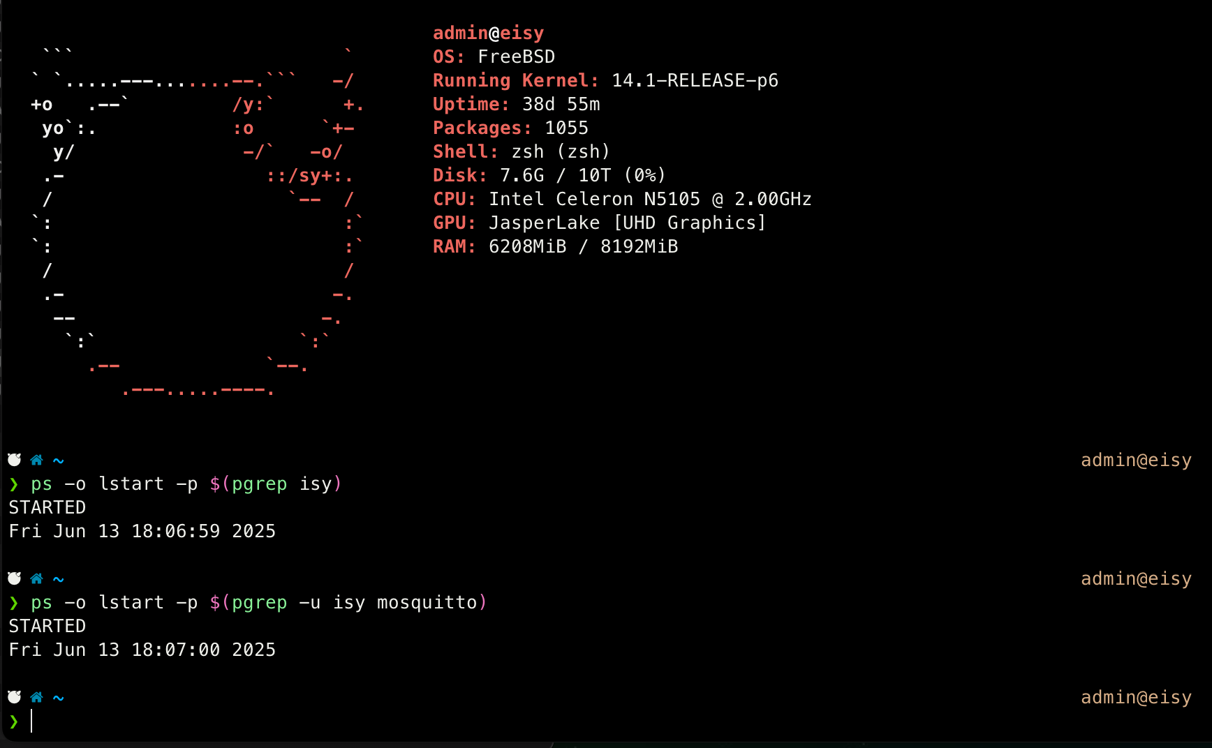

Can you check the start time of the Mosquitto service and the isy service? I bet Mosquitto restarted after isy.
isy:
ps -o lstart -p $(pgrep isy)
Mosquitto:
ps -o lstart -p $(pgrep -u isy mosquitto)

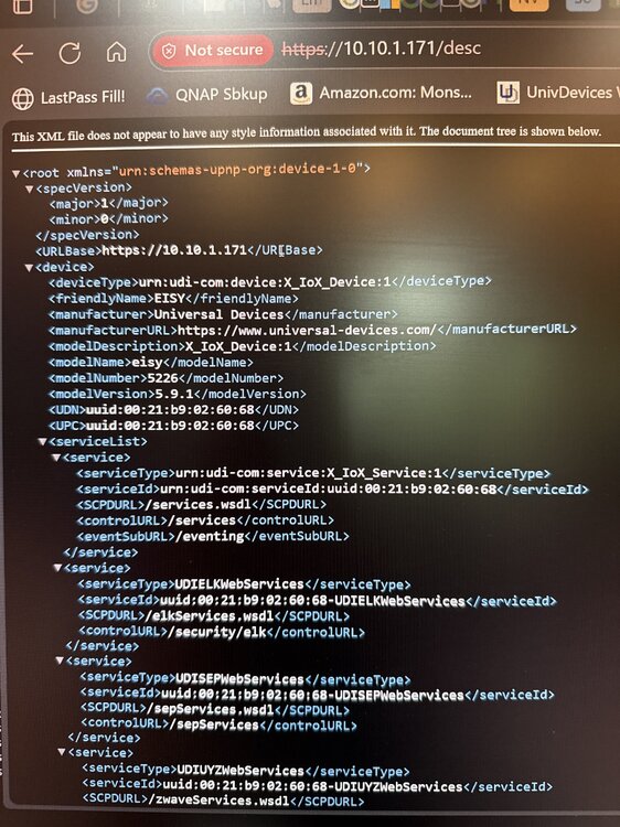

Great , I can see the process running now. I cleared edge browser cache and browsed to :
https://10.10.1.171/desc
and http://10.10.1.171/desc but I get an xml error
I don't seee any xml error. If you are referring to the "Not Secure", this is due to the self signed cert.
isy:
Mosquitto:
@bmercier you are correct (of course)!  But you gotta share how you came to that conclusion.
Actually, just a difference of 1 second is not what I expected. My theory falls apart.
Still searching for the cause.

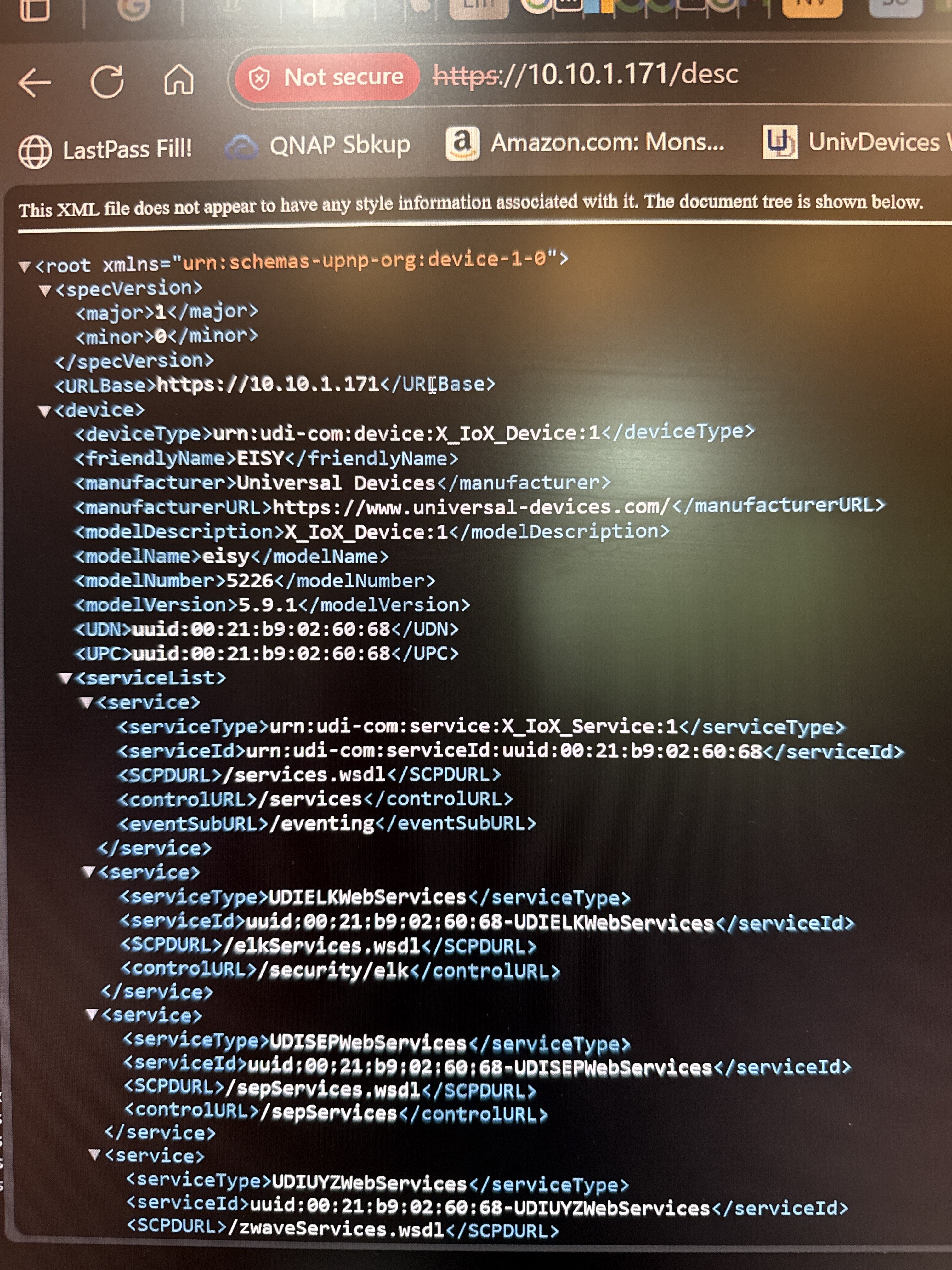

I installed 0.5.8 but still get the same XML file error, see image.
Update: if I use http://10.10.1.171:8080 without the /desc I can get in to the AC, but
I have to login with my previous AC userid and password not those of the portal.
The screen shot output is as expected.
To login in the admin console, regardless of the port use, it needs the /desc at the end. And yes, on port 8080 you need to use the IoX user and password.

My issue with the local plugin is very odd.  A few fields are updating on some of the nodes, but only a few and not real-time.  I get this is much lower priority, let me know if it gets to the top ten list.
With the prior version, when pointing your browser to http://eisy.local, you could get a "Not Found" error instead of the UI. It worked only if your browser had the UI in cache. If you would have tried in another browser, it would not have loaded. 0.5.8 fixed that.
The problem with the status has to do with how the plugin sends the status and/or if the node was queried. So if you had a status change since the last reboot, eisy-ui and AC should be getting them. If a status has not changed since the last startup, this is when you may not be getting them. In the plugin, when setDriver is called, you can force sending the update. Your plugin probably doesn't.
Let me share some more info on how things works.
When a client (AC, UDM...) requests a subscription, it also sends a request to get the latest states. IoX then sends the latest nodes properties, which the client uses to display them.
In eisy-ui, it's a bit different. When a client connects to eisy-ui to get a subscription, the protocol is essentially the same as when connecting to IoX directly. What's different is how eisy-ui gets events from IoX. When a subscription is requested (either internally or from a client), it starts a mqtt subscription to an events channel. events are sent from IoX on MQTT topics that eisy-ui reads. Those events have the "retain" flag set. This means that the MQTT server keeps the latest copy of those events, and whenever a client connects, it sends them along.
So technically, the results should be the same, but obviously, it's not in your case. Your tests tells me that somehow, IoX is aware of past events, but those same events are not stored with the retain flag in the MQTT server.
In your case, the problem is only with your plugin in dev. But that does not really matter, IoX does not know about whether a plugin is in dev or beta or prod.
So bottom line, those properties that have a status must be because the status changed since the last startup. What I don't understand yet is how can IoX know about a propety, and not MQTT...
@bmercier first, thank you for taking the time to explain the plumbing a bit.  Not only helpful but very interesting.
Second, you are right I was not forcing when sending my updates, I had left the defaults.  Changed that and all of a sudden I am updating just fine in the local dev mode to the eisy-ui.  Not sure if there is any penalty for this beyond a bit more traffic and time; but I cannot observe any side-effects.
self.setDriver('GV6', self.shadedata["batteryStatus"],report=True, force=True)
(the report=True is already default)
I will go with this method for now.  Thanks again.
