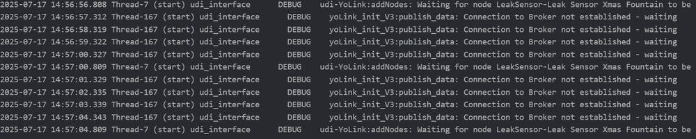

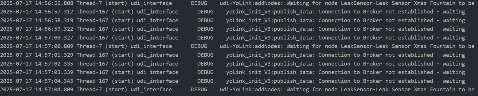

@Panda88OK thanks. I installed it but it seems to stall out and be caught in a loop trying to enroll one of my leak sensors. It successfully enrolled 9 others prior to this. This leak sensor shows fine in the yolink app and the production version of the plugin. I tried restarting the plugin with the same result. Here is a snippet from the log file
It makes little sense that other leak sensors work and one does not - maybe give it a try a little later - sometimes there are issues on the server side
@Panda88thanks, you were right. I just restarted the server and all devices enrolled ok.
