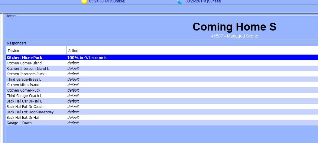

2) Lots of scenes no longer have settings for the devices but rather say "default".  Not all of them, but in some scenes it is all, other scenes just one device, some scenes none.  Below is a scene that is supposed to have levels for all those devices.

I've discovered if I take a scene that is not lost its settings to "default" and go down the list of devices and hit "update" for each device.  The scene then works.  What gives?

Tried restoring two other ISY backups, another one from a few days ago and one from 6 months ago.  They all are the same.  Most of my scenes have "default" instead of the settings that are supposed to be there for all the devices.
And the same restoring a 2 year old backup
