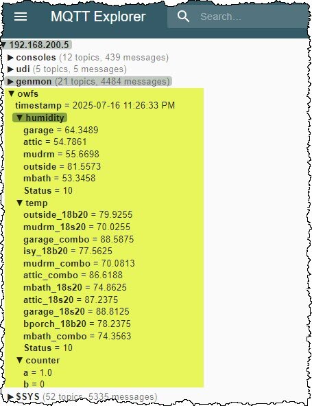

I have an RPi running the OWFS (one-wire file system) for a series of 1-wire devices (humidity & temperature sensors and a counter).  This RPi also runs the NodeLink (PG1 era) node server mentioned above.  On this RPi, I added a python script to read the 1-wire values from the OWFS system and post them to my MQTT Broker as 'strings'.  Below is a screen shot from MQTT Explorer showing my 1-wire sensors.  My script only posts the string values representing the numeric data for each sensor.

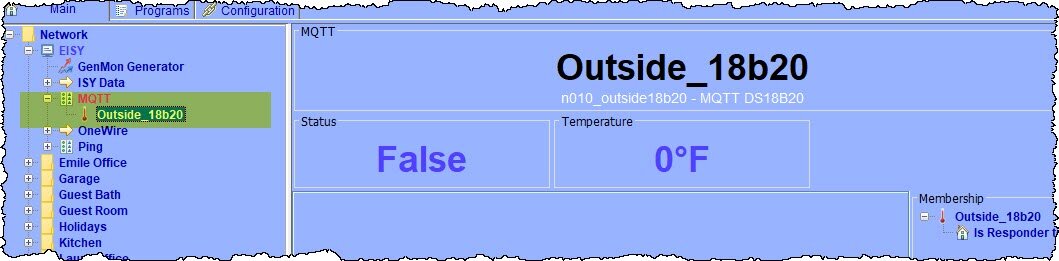

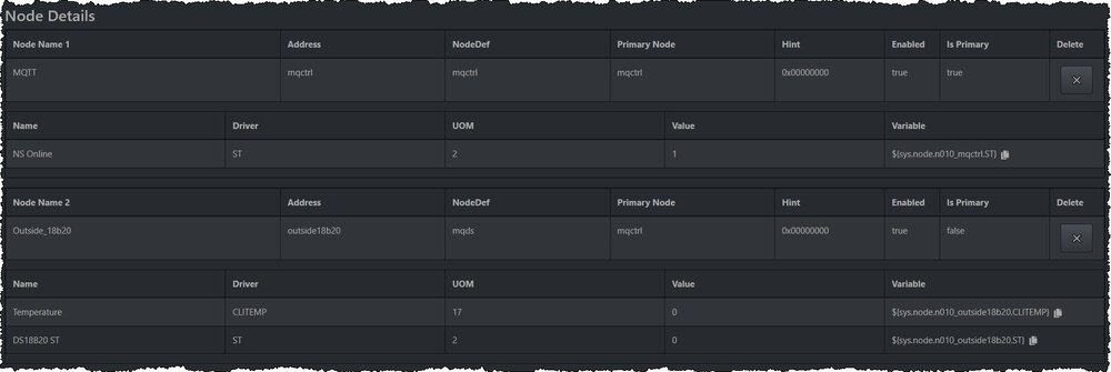

PG3:  PG3 shows two nodes.  The first is the MQTT and the second is the Outside_18B20.
The EISY shows the Outside_18B20 device but it has a value of 0.

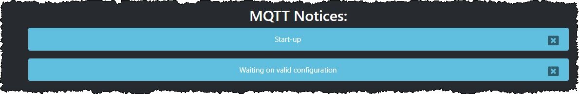

5. This is not a question but a comment.  I continue to receive the following two notices in PG3.  My MQTT broker runs on a RPi and does not use a username and password.  So, those fields are blank in your MQTT plugin configuration page.

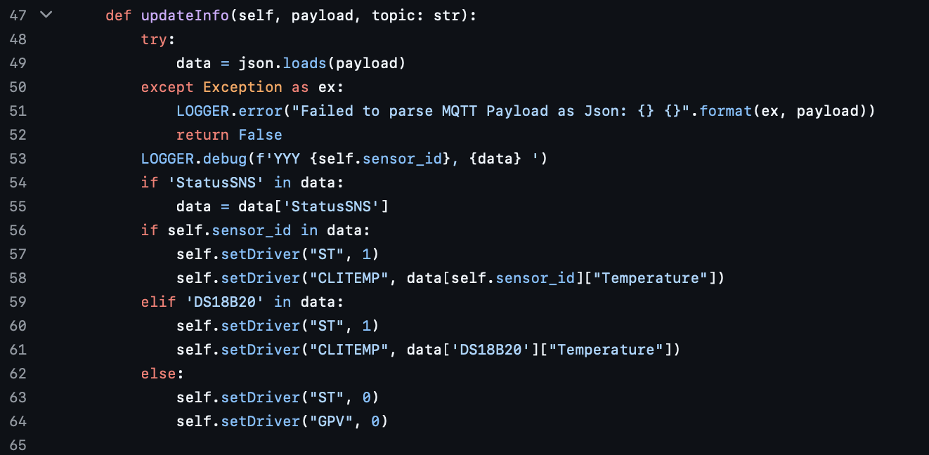

Hi Emile,  since @TriLife is travelling I will jump in,
You are close, you data is just not where the node is looking for it.
Attaching a link to the relevant node and a screenshot of the part of the program which is relevant (I wrote this device a long time ago to get the temp for a fish tank and the lake)
https://github.com/sejgit/udi-mqtt-pg3x/blob/main/nodes/MQds.py
If you look at the topics its getting the data, its under the sensor id topic and under that you need the Temperature variable.  So basically just add another layer.  I know this seems odd for this device but many of the other devices have Humidity, heartbeat, etc.
Temp is fine as the device choice.  Many of the devices added were not Sonoff as that was my original use case when I added them to the original plugin, @TriLife has brought the focus back to Sonoff as that is his use case.
If you want to learn more about the different devices like raw and Analog, take a look in the python scripts of the devices in the plugin from the github link above.  You mention you are programming in python so shouldn't be much of a stretch to figure out what they are doing.
