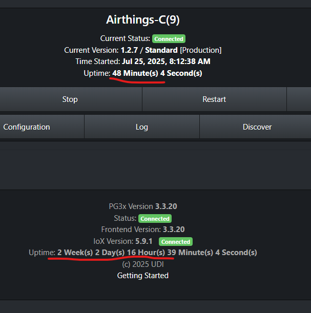

Here's a screenshot showing how PG3 has been running for a couple of weeks now while the plug-in has only been running for less than an hour (when I took the screenshot).

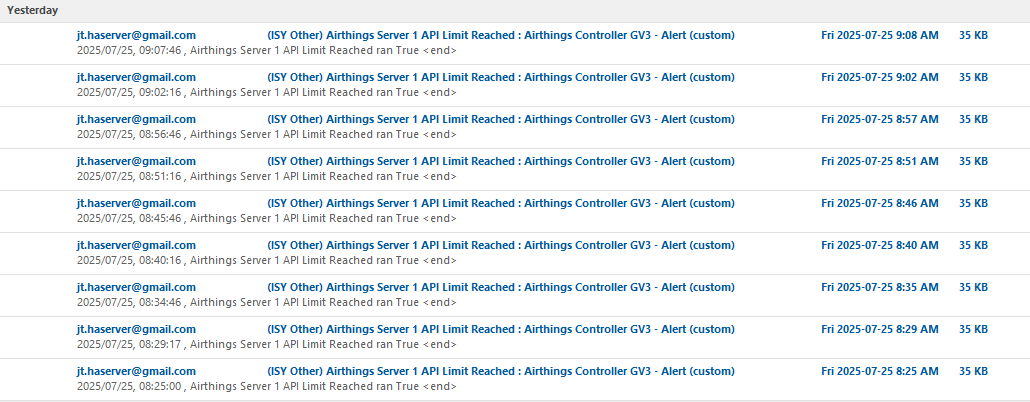

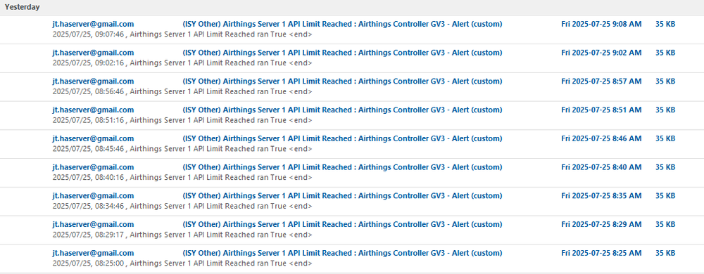

Just to provide a visual, I have a program that notifies me by email when Airthings API Limit has been exceeded. Here's an example of what I get in my inbox when I restart IoX:
