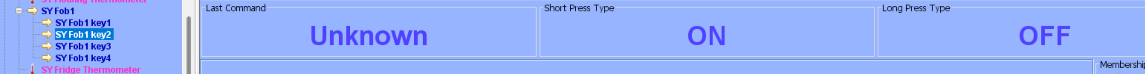

I added a Yolink mini on/off fob YS3614-UC (mini fob, not "regular" on off fob) This is a two button mini fob. The YS3614-UC is exposed by the Yolink plugin with four parameters: Key One, Short press, Key One Long Press, Key Two Short Press, Key Two Long Press. Configured the YS3614 so key One short press is DON, Key One long press is DOF, Key 2 short press DOF and Key 2 Long press DON. Adding the YS3614 to a to a program and using the only available "control" conditions I can turn on and off an insteon switched light.  Control key 1 is on and light turns on, control key 2 is on and light turns off. I can see the last command in the Admin console tab for each of the two keys in the fob.

They are exposed as Key One, Short press, Key One Long Press, Key Two Short Press, Key Two Long Press. Key Three Short press, Key Three long press, Key Four Short Press, Key Four Long Press.  Configured in same pattern as YS3614. Key One Short Press DON, Key Two Short Press DOF, etc.  Add it to the existing program Control on etc
The YS3605 switch one works once, to turn on the insteon light with switch one. The YS3605 switch two never works to turn orr the insteon light.  Turning off the insteon switched light by "hand" and now the YS3605 switch one creates an admin console error of inability to communicate with the insteon switched light.  Also the admin console only shows last command for key 1.  The others, key 2 key 3, key4 always say unknown, no matter how many times I push those fob buttons.
I have to use the YS3614 to turn the insteon switched light on and off.  Then the YS3605 will again turn the light on only once.

you should have 4 sub nodes where you define the operations for each press type. i have the same fob and it works
Are you trying to use a scene to control this ?  I still believe it should work, but I have not tried it
I have used programs mostly with this one
Send me a debug log (enable debug and press the different keys are few times)

The YS3605 is exposed in the Admin Console as a four button device, however it really functions as a two button device with long and short press messages: Green button 1 gives button 1 short press, Red button 2 gives button 1 long press, Green button 2 gives button 2 short press, Red button 2 gives button 2 long press. button 3 and button 4 do not seem to exist. Make sure programs only expect information from button 1 and 2 (not 3 or 4).

Can you send me (PM) a log with debug enabled and some key presses - I have the 3604 and is offers both long and short on each key - I also got the mine on/off and it seems to offer both long and short from each button
