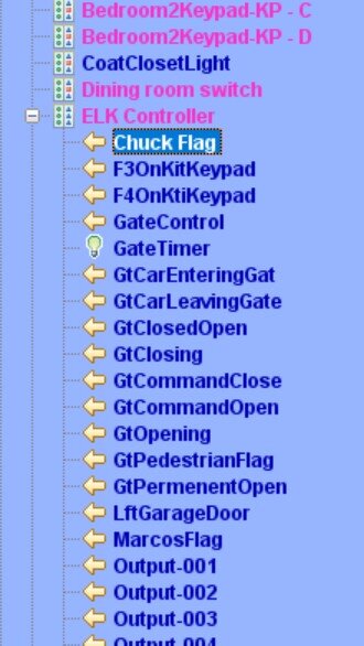

Getting arrows on my Elk Controller
What is going on?  None of my outputs are being queried.  See uploaded image.
Arrows mean the isy identifies it as a dry contact device. This arrow means it's a contact device that controls something... turning it on from iox will trigger the contact. You'll see that on/off status by clicking one of them and looking at the iox panel for it.

Actually, some of the outputs are flags and are defined in the Elk, some of the outputs are non-existent because I have to go up to output 197 (which is the relay control for the M1KAM module).
I have never seen the arrows before.  It sure looks like the eisy is trying to go out and get the outputs, but it can't.
