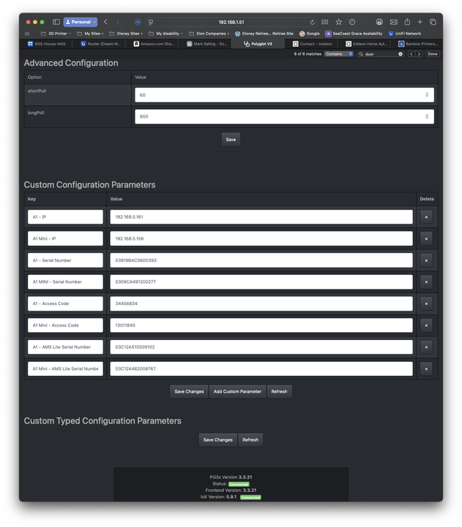

GSutherland Posted yesterday at 10:01 AM Posted yesterday at 10:01 AM Hello, I must be doing something wrong. I want to send you the files you asked for and also screenshot the information from both my printers. Please call me and let me know where I drop off Thank You very much! Stephen Gary Sutherland BambuLab_9-3-2025_125720_AM.zip BambuLab_9-3-2025_125722_AM.zip Quote

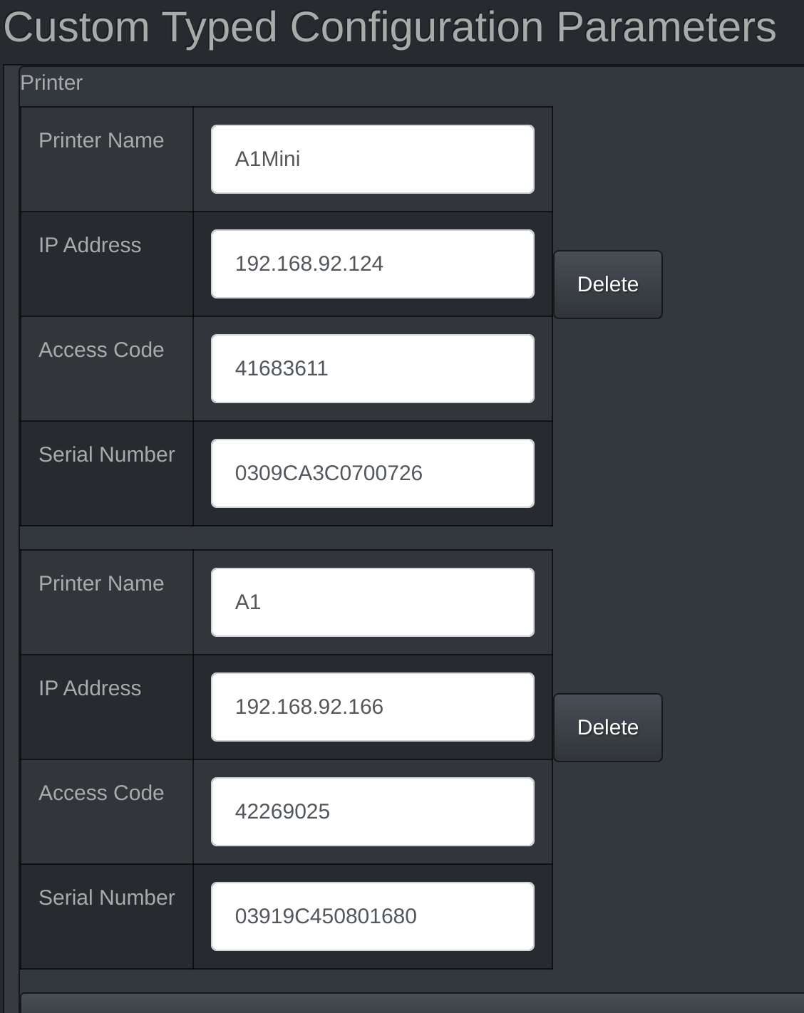

bpwwer Posted 22 hours ago Posted 22 hours ago You don't have the configuration correct. The Bambulab plug-in uses the custom typed parameters, not the custom parameters. If you scroll down below the custom parameters, you see the custom typed parameters. Use the Add button to add a new printer. This is what mine looks like for my two printers 1 Quote

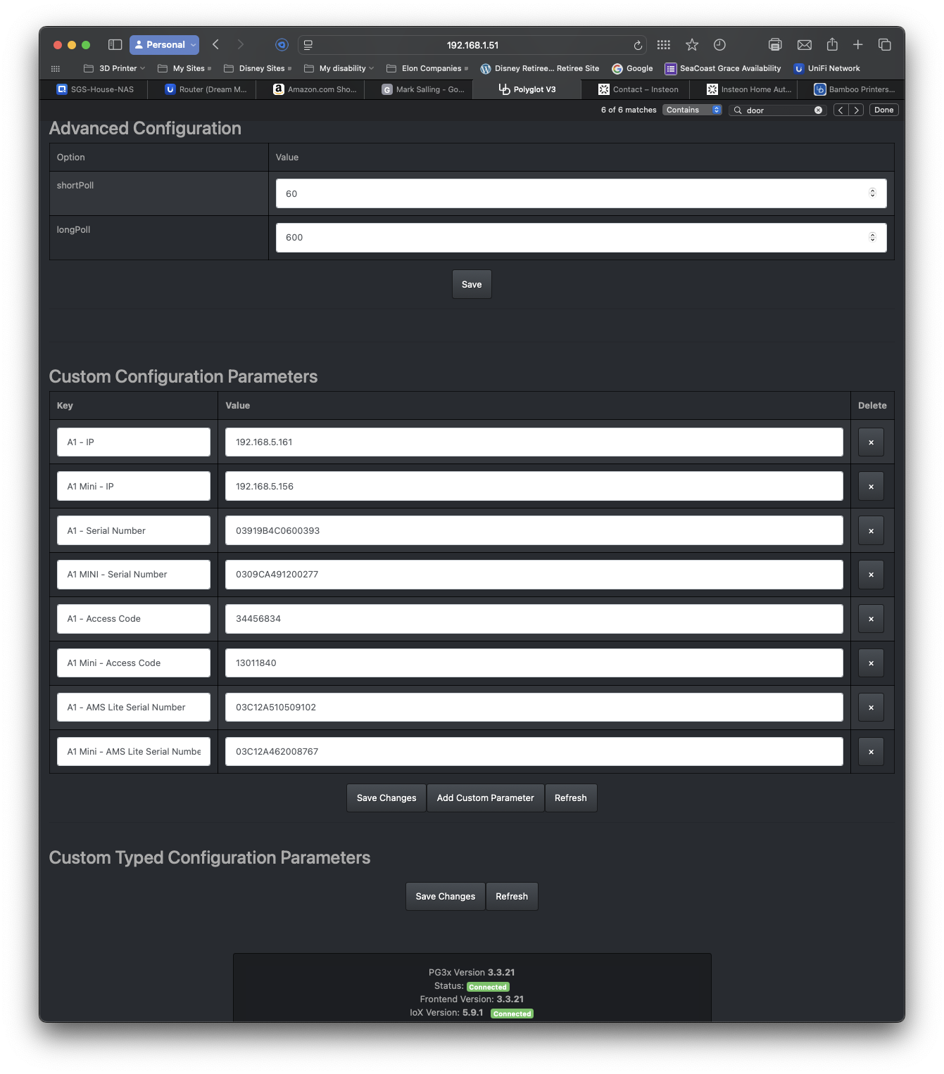

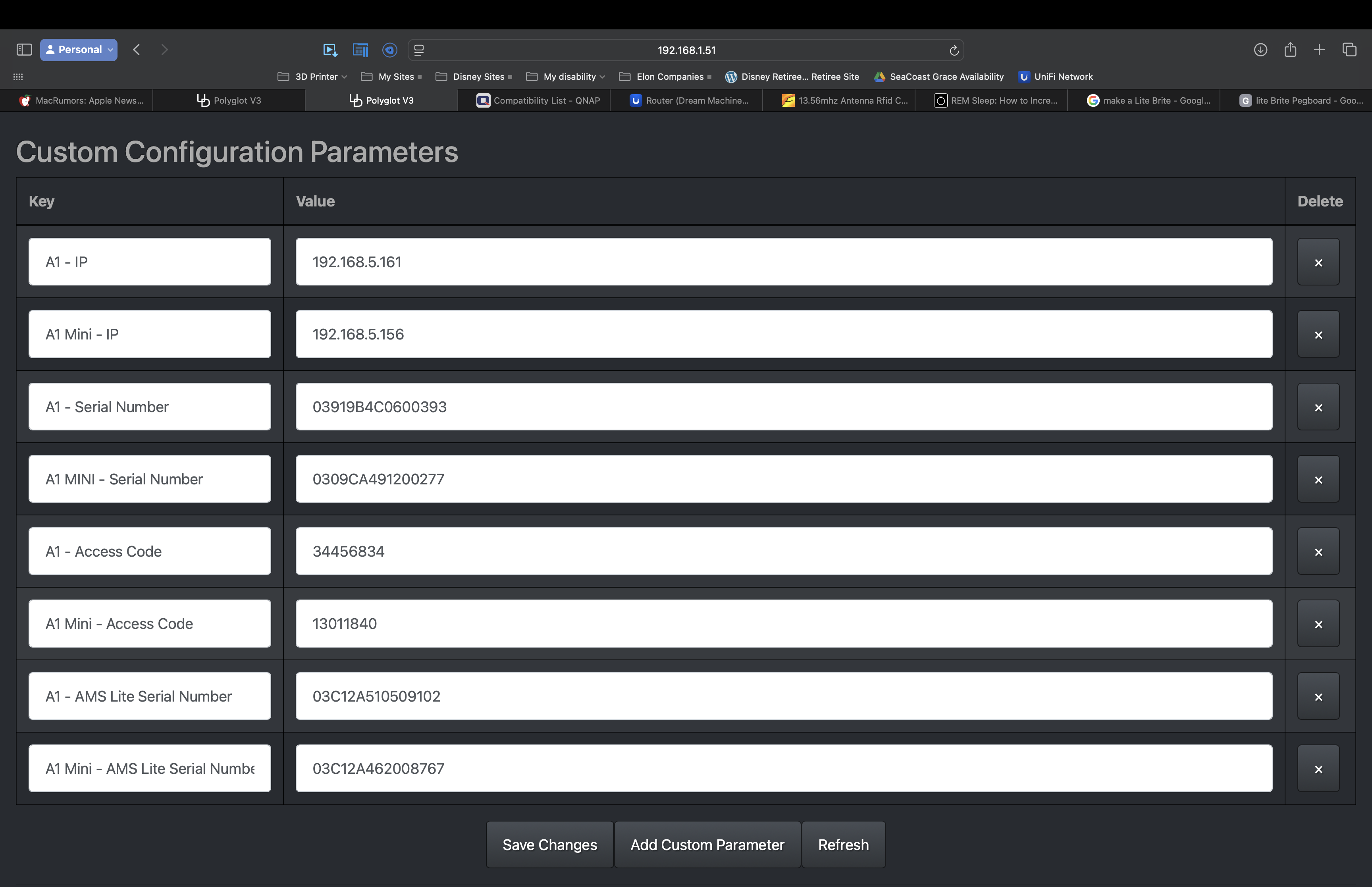

GSutherland Posted 13 hours ago Author Posted 13 hours ago Hello, thank you for getting back to me but here's another screenshot. I don't see what you were speaking of in regards of being below where I input it all this information. Quote

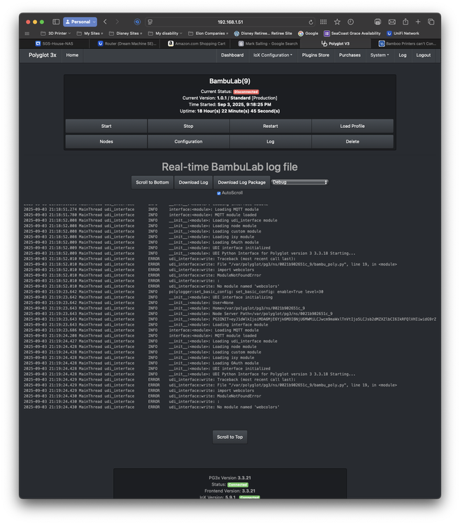

GSutherland Posted 10 hours ago Author Posted 10 hours ago I also wanted to send you some errors that I am seeing Quote
