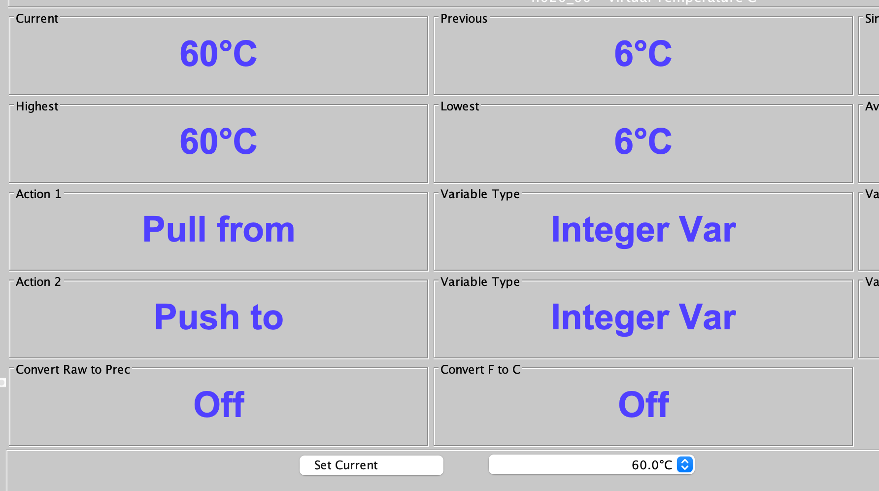

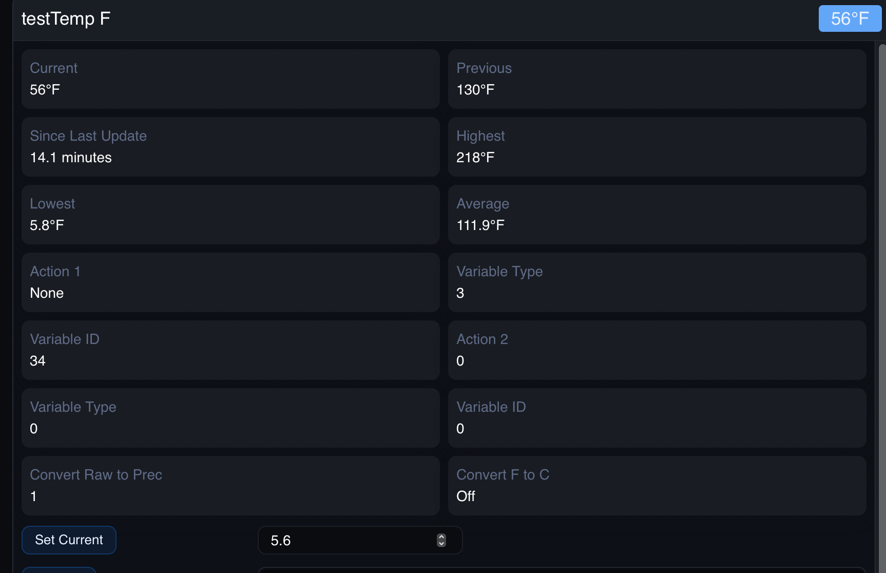

@bmercier, the precision on display seems to be different between the entry number and the actual in Current versus Set Current:
for some reason Set Current in the Eisy-ui is one tenth.  Whats interesting, is the number you enter goes in properly but then shows as one tenth down below:
correct in AC:
Not in eisy-ui:

@sjenkins thanks for reporting this. It will be fixed in the next release.
The problem seems to happen when the precision on the editor is different than the precision on the value.
In this case, although the precision on the ST prop is also 1, I think the plugin is setting values with a precision of 0.
