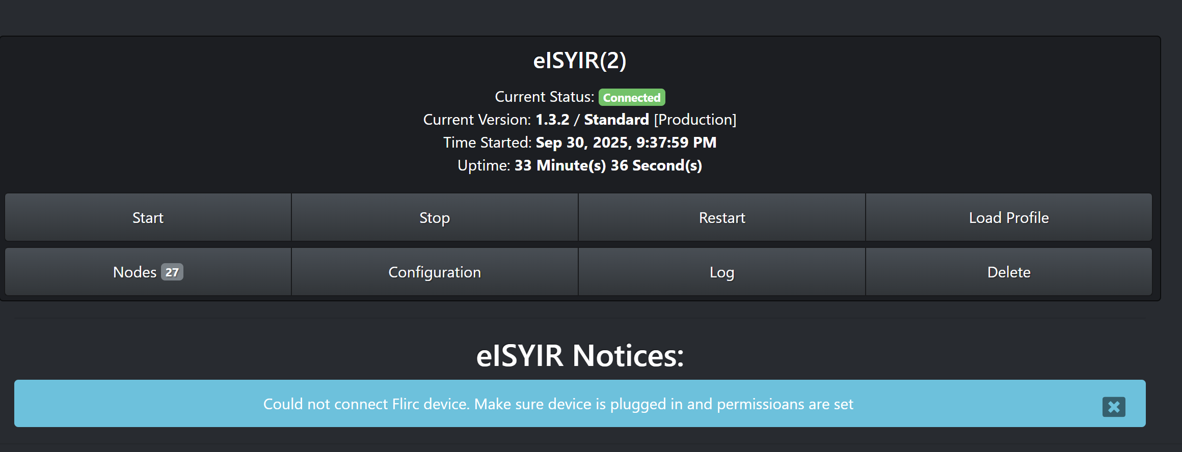

I have just upgraded my eisy to OS14.3/IoX 6. I am now getting the error message
Could not connect Flirc device. Make sure device is plugged in and permissioans are set
see screen capture below. I have tried unplugging and plugging the Flirc device but no luck. Everything was working fine before the upgrade. Any suggestions would be appreciated.
If you're capable of running ssh commands, PM me and we can try to figure out what have gone away. I can also probably tell you how to get it back temporarily.
I had also opened a ticket with Michel and it appears that we have resolved the issue. Evidently it was a permissions related issue. We went through a number of uninstalls and reinstalls of the plugin as well as restores of BG3 and IoX backups. It took a number of hours of elapsed time but at this point the IR functionality seems to be working. Thanks for getting back to me.
