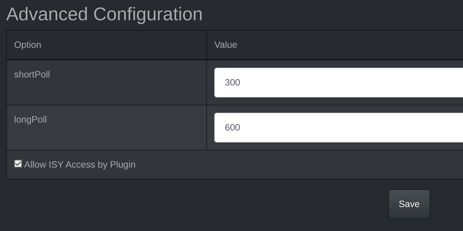

One thing I just thought of, for ST-Inventory to work, you do have to check the checkbox on the config tab to allow the plug-in to access the IoX/ISY.
and make sure you hit the save button after checking the check box.

it was checked on both EISY and not working.
I did two things today. Upgraded to the latest pg3x .22 to .23
then I deleted the nodeserver, reinstalled (Same slot), and checked box.
Now its working!!!
So don't know if the .23 fixed it or the reinstall. But I had reinstalled before.
Neither Benoit or I was able to reproduce this, ST-Inventory was working for both of us.
The error looks like it could be caused by the checkbox not being checked. I know at least once, I checked the box, but forgot to save it causing a very similar error.
