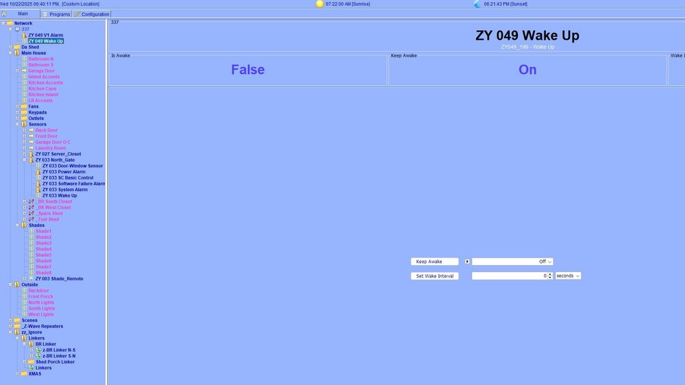

I have a few AEOTECT recessed door sensors and have always been able to get them discovered after a couple tries of adding and removing the device. In this case, I have two new sensors and no matter what I can think of trying, they show up as "ZY049 V1 Alarm" with sub-device "ZY 049 Wake UP". I expect to see the Door-Window Sensor, the Power Alarm, etc. (screenshot attached showing the new device at top, and existing device ZY 033 about midway down the device list.

I'm not 100% sure of the terminology, but 337 is the container for the entire network. It is where devices go when I "remove from folder".
Edit: screenshot attached
Edited by walkman9999
added screeenshot

I noticed you have 3 nodes for ZY055 basic control, there should only be one node.

I have repeated the remove/include process multiple times. Both inclusion and removal are quick. Removal works as expected with all components removed from EISY tree. Inclusion triggers the interview and the result is some subset of the total components of the device showing up, sometimes just the alarm and wake-up, other times (as pictured) with everything except the "Alarm Controller" which is the main component that the subs get nested under when present.

What's uncommon is that you have 3 instances of ZY055 basic control, you should only have one.
