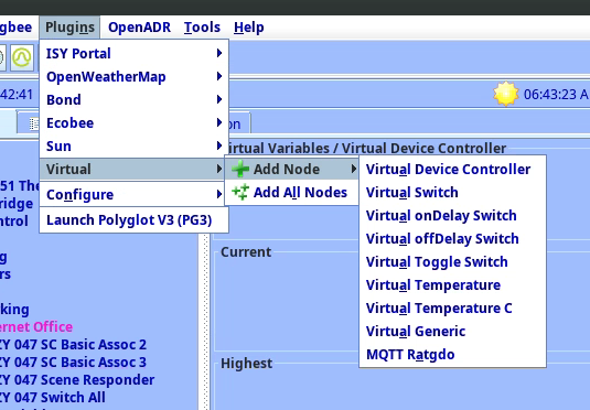

I could see the Plug-in was added to the AC and if I clicked on the AC Menu item I saw I could add a Temperature Node.Screenshot 2025-11-09 at 12.42.43 PM.png

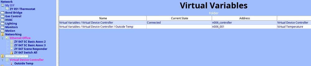

So, I clicked on Virtual Temperature and added a new n006_0001 node address and it shows in the node list

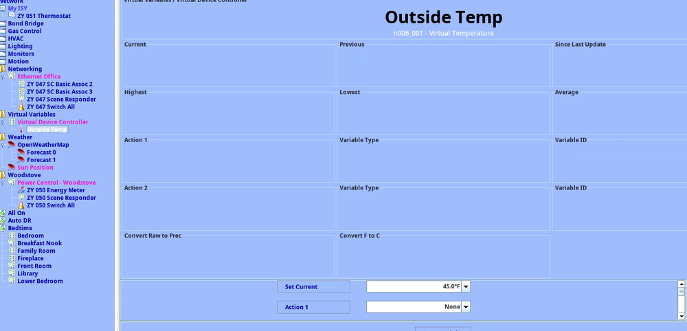

So, then I created a program to update the Current value to my variable I am trying to convert to a node.
Even if I force the program to run nothing changes for the new Outside Temp virtual node and all the fields remain empty.

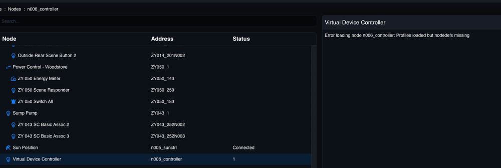

When I went back to the eisy.ui nodes page it reports an error saying that the nodedefs are missing for the Virtual Device Controller.

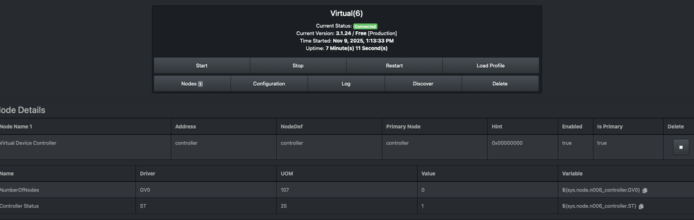

and the Virtual Device Controller shows...
Even though I added the Outside Temp node during trying to set this up, the Virtual Device Controller show ) for the Number of Nodes. Does this make sense?

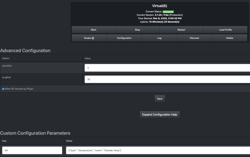

Most of my problems were in PG3x and I did not have the configuration complete and I was missing the proper Custom Configuration for the node.Screenshot 2025-11-09 at 3.21.15 PM.png
Once this was corrected, everything started to fall into place.

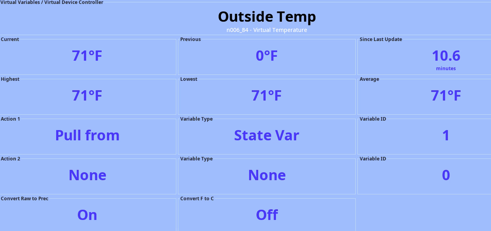

The AC started to populate and I was able to write a short program to force it to update automatically, since in this case it is truly a dynamic variable.Screenshot 2025-11-09 at 3.23.27 PM.png

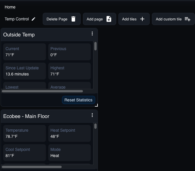

From here adding the variable (essentially as a node) to the eisy.ui Home Screen was straight forward
I guess my one feedback is that in creating tiles for the eisy.ui Home Screen we are not given any options to only add select components of the node and all the data from the node loads into the tile.
If we are trying to create a concise Home Screen overview page, this adds a lot of extra data (or clutter). For a eisy.ui home page were we want to be able to control everything about that device, then this is fine.
This was my first dive into the eisy.ui home page and it is a great feature. Great work.
You can choose what properties and what commands.
The thing is, when you use "Add tiles", it creates a tile based on a node, including all properties and commands.
Edit your tile, click on the properties widget, and select the properties you want. Same for commands & buttons, you can keep only what you want.
Alternatively, you can click on "Add Custom tile" to have an empty tile you can create as you want it.
@bmercier Thank you... I knew there was something that I was missing. I played with setting the properties a little and sort of got the hang of it... a lot of clicking to get everything set... but I assume that will get easier over time.
Many thanks..
