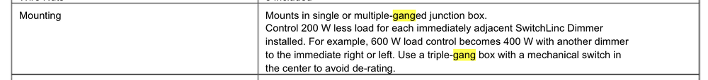

There's this obscure comment down in that (most other dimmer) switchlinc's manual. If you've side-by-side double ganged the switch, the rating for the switch drops significantly. If there are 3 in a row its really low.
If your's is multi-ganged, it may have worked at one time but probably over time lead to the the failure of the switch
Edited by paulbates
Interesting, But it's in a triple gang box but with a blank next to it and a standard switch in the third position.
