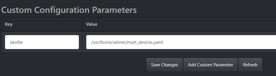

2) I added my .yaml file name in the MQTT configuration entry
3) I added the below entries in my .yaml file (I have two droplets). The status and cmd topic entries are the unique value displayed in the phone app, type: must be "droplet", id: and name: are what I chose.

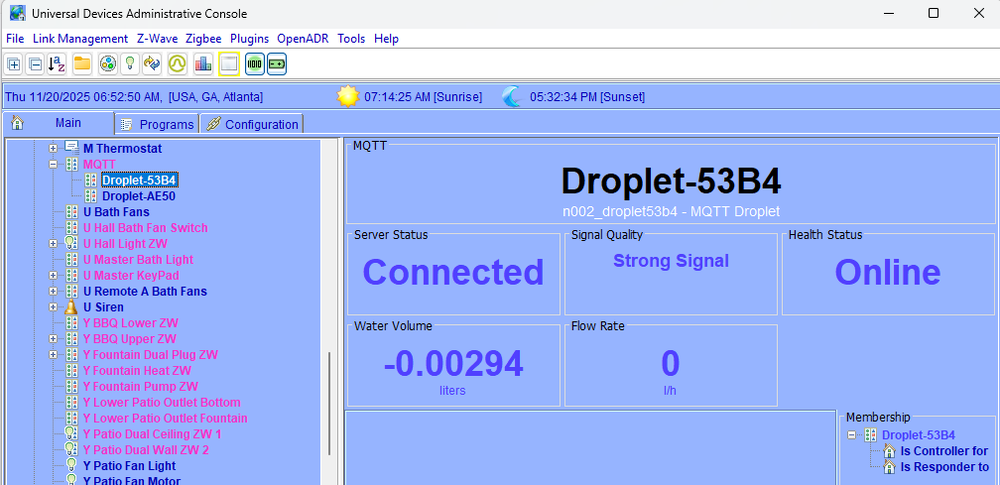

Once I restart my MQTT to pick up the entries, this is what I see in the console:
I created a test program to notify on flow and that worked as well.
